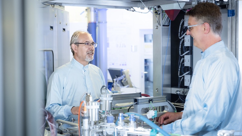

In pursuit of a silicon-compatible semiconductor capable of bridging electronics, photonics, and quantum technologies, researchers at Forschungszentrum Jülich and the Leibniz Institute for Innovative Microelectronics have developed an alloy of carbon, silicon, germanium, and tin, which represents an unprecedented combination within Group IV
Dubbed CSiGeSn, this material overcomes long-standing chemical incompatibilities (such as the disparity between carbon's and tin's atomic radii) by refining epitaxial growth conditions using off-the-shelf chemical vapor deposition (CVD) systems. The result is a structurally stable, compositionally uniform crystal lattice that remains compatible with existing CMOS manufacturing.
Dr. Dan Buca (left) and Andreas Tiedemann (right) at the CVD system
Dr. Dan Buca (left) and Andreas Tiedemann (right) at the CVD system from Aixtron, used for coating the wafer. Image used courtesy of Forschungszentrum Jülich
The unique blend enables bandgap tuning beyond what’s possible with traditional Group IV semiconductors alone, opening up new device behaviors at room temperature—particularly in optoelectronics.
Early demonstrations include the first quantum-well light-emitting diode (LED) fabricated from this quartet, offering a proof of concept for integrated lasers, photodetectors, and thermoelectric devices directly on silicon wafers. Because it maintains lattice continuity while adding new electronic and photonic degrees of freedom, the alloy could lay the groundwork for scalable on-chip quantum and photonic computing, energy-harvesting systems, and advanced wearables.
