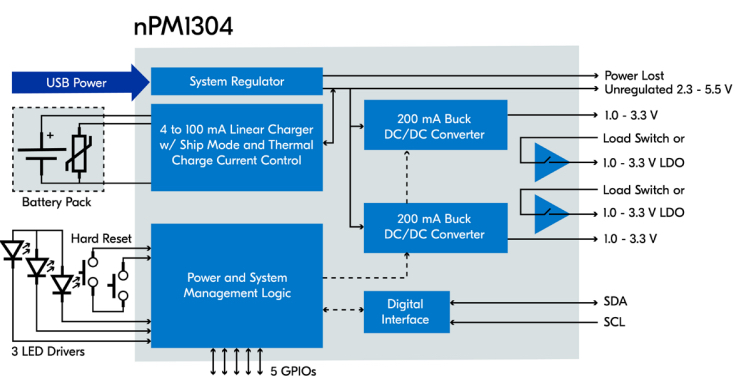

The nPM1304 delivers comprehensive power management that includes two 200-mA buck regulators and two 100-mA load switches (or configurable 50-mA LDOs), offering four independently controllable power rails. Each rail supports fine-grained voltage regulation between 1.0 V and 3.3 V, and the device also integrates a USB-C compatible input regulator with a 1.5-A current limit that supports input voltages from 4.0 V to 5.5 V and tolerates 22-V transients.
The nPM1304 features a model-based fuel gauging system, which estimates battery state of charge using voltage, current, and temperature metrics. According to Nordic, this method provides accuracy comparable to coulomb-counting solutions but consumes significantly less power—down to 8 µA in active mode and zero in sleep mode. By contrast, traditional fuel gauges may draw up to 50 µA actively.
Block diagram of the nPM1304
Block diagram of the nPM1304. Image used courtesy of Nordic Semiconductor
Battery management includes a linear charger compatible with Li-ion, Li-poly, and LiFePO₄ chemistries, with programmable charge currents ranging from 4 mA to 100 mA and termination voltages adjustable between 3.5 V and 4.65 V.  System-level features mirror those of the earlier nPM1300, including watchdog and boot timers, a power loss warning system, hard reset functionality configurable for one or two buttons, and recovery from failed boots. The PMIC also faces an I2C-compatible two-wire interface for dynamic developer system configurations, as well as five general-purpose I/Os and three LED drivers.

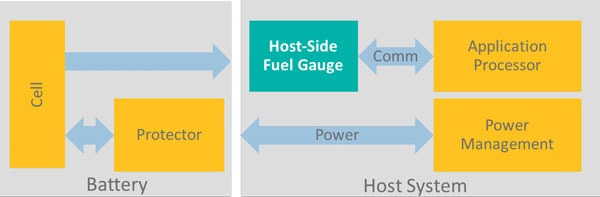

A host-side fuel gauge
A host-side fuel gauge. Image used courtesy of Analog Devices
Coulomb counting also imposes a continuous power overhead. The sensing and integration circuitry must remain active during device operation. This can be problematic in designs with tight energy budgets. In some miniature applications, where average system current is in the range of a few hundred microamperes, the coulomb counter alone may consume a substantial percentage of the total available power.
