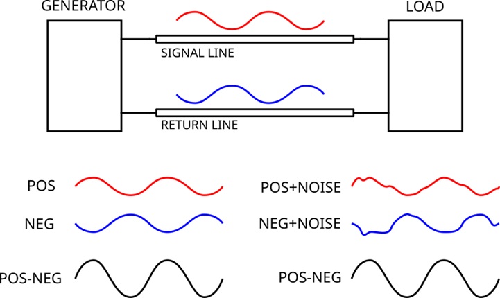

Figure 1 demonstrates the basic operation of differential signaling between a generator and a load.
Differential signaling eliminates common-mode noise.
Figure 1. Differential signaling eliminates common-mode noise. Image used courtesy of Sam Gallagher
You're likely familiar with the idea that a system with purely differential signals is immune to interference because noise introduced into one signal is equally introduced into the other. A common example is data transfer over a twisted pair. To help us generalize this concept, let's examine that example further.
The Twisted Pair
In a twisted pair, capacitive coupling of noise onto two conductors is "eliminated" by the fact that the same amount of noise is coupled into both. The differential receiver only cares about the difference between the signals on the two conductors. The two signals being equal and opposite along the length of the transmission line is essential to maintaining the noise-cancelling effects on the receiving end. (The common-mode rejection at the receiver will also have a significant impact, of course.)
In short, the signals need to be balanced with each other, i.e. equal and opposite. They also need to be balanced with respect to any interfering signals and their corresponding sources, i.e. coupled equally to them.

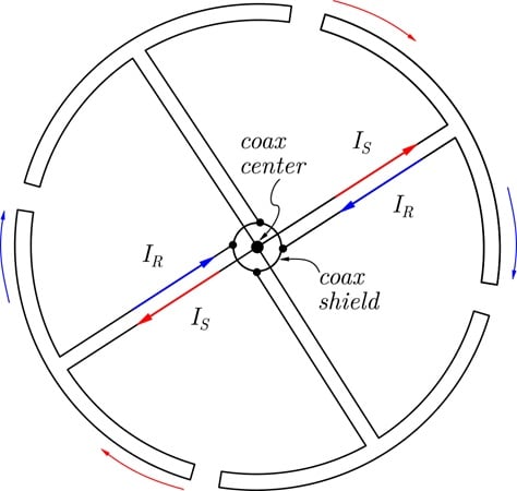

There were two antennas designed for the top of the Empire State Building, one for television (the 'vision antenna') and one for audio (the 'sound antenna'). It was necessary that the two antennas not couple into each other.
To meet this requirement, the vision antenna was made from four ellipsoid conductors. The sound antenna was similar to a circular loop antenna, but made of folded dipoles. The design of the sound antenna can be seen in Figure 2. Note that all lines in the figure represent wires.
Empire State Building sound antenna, schematic representation.
Figure 2. Empire State Building sound antenna, schematic representation. Image adapted from Lindenblad
Here we have four loops like spokes of a wheel. Two diametrically opposed dipoles have signal currents coming from the coax center (shown in red) flowing around the segments of their thin loops, and then returning to the coax shield (shown in blue).
The system is designed so that undesired currents induced by the vision antenna, which was installed vertically several meters below this one, will be in the same direction along a given conductor. The induced currents on a given pair of signal lines will thus be equal and in the same direction, passing over rather than entering into the coax feed line. To quote from the Lindenblad article:
The common feed line is so connected to the feeders of the individual radiators that the currents in opposite radiators become opposite. Currents, which on the other hand are induced by the turnstile antenna, are of same direction in opposite radiators. They must therefore balance each other without entering the common feed line.
For this to work, however, we need current to be conserved on the antennas. Thus, the transmission line feeding the antenna must not allow any additional current path apart from its equal and opposite currents on the center conductor and shield. In other words, the coax must enforce the condition of balance when feeding the antenna. The solution was a "line balance converter," which is now known as a bazooka balun.

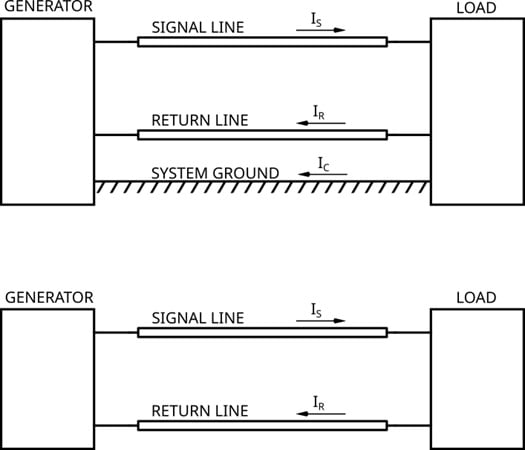

To make our discussion more concrete, let's examine the two system models in Figure 3.
Two models for defining electrical balance. When coupling occurs between either line and the system ground, that coupling can be included in the generator or load blocks.
Figure 3. Two models for defining electrical balance. When coupling occurs between either line and the system ground, that coupling can be included in the generator or load blocks. Image used courtesy of Sam Gallagher
The first model includes a system ground. The second has no system ground. Both are driven by a "generator" block, and transfer signals into a "load" block. These simple models are general enough to describe many cases of interest in data transmission and transmission line/antenna problems.
We assume the signal and return lines have currents which are position-dependent. This means that you can have standing waves and other wave features in the currents along their lengths. Coupling between the signal and return line and the system ground can be included in the generator and load blocks, as can any additional connections to transmission lines or antennas.
With these models in mind, we can restate our two variant definitions:
  • Coupling definition of balance: A two-conductor transmission line is balanced when its signal and return lines are equally coupled to either system ground or a third conductor.
  • Point definition of balance: A two-conductor transmission line is balanced at a position when the current on the signal line is equal and opposite to the current on the return line at that same position.
