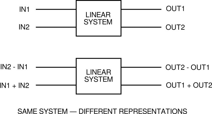

In a system with two inputs and two outputs, we can view the inputs and outputs as individual excitations. Equivalently, we can define a sum and difference of the inputs (and outputs) and obtain a description of the system in these terms. In electronics, we often refer to the sum as the common mode and the difference as the differential mode.
This same concept appears everywhere in physics and engineering, though the name it's given depends on the discipline. In microwave engineering, it's called even-odd mode analysis. In control theory, they refer to the change in description as a similarity transformation. In physics, it's found as eigenmodes of a coupled mass-spring system. All of these names refer back to the same concept.
To express this idea analytically, consider Figure 1. This is a linear four-terminal network with input terminals Vi1 and Vi2 and output terminals Vo1 and Vo2.

This is a perfectly reasonable description of any linear system with two inputs and two outputs. But an equivalent representation can use Δi = Vi2 – Vi1 and Σi = Vi1 + Vi2, so that solving for Vi1 and Vi2 gives:
$$\begin{align} V_{i 1} & ~=~ \frac{\Sigma_{i}~-~\Delta_{i}}{2} \\[.5em] V_{i 2} & ~=~ \frac{\Sigma_{i} ~+~ \Delta_{i}}{2} \end{align}$$
Equation 3.
The transformation to Δ and Σ variables can be defined by the transformation matrix:
$$E ~=~ \begin{bmatrix} -1 & 1 \\ 1 & 1 \end{bmatrix}$$
Equation 4.
This is an example of a similarity transformation. It results in:
$$\begin{bmatrix} \Delta_{i} \\ \Sigma_{i} \end{bmatrix} ~=~ E \begin{bmatrix} V_{i 1} \\ V_{i 2} \end{bmatrix}$$
Equation 5.
and:
$$\begin{bmatrix} \Delta_{o} \\ \Sigma_{o} \end{bmatrix} ~=~ E \begin{bmatrix} V_{o 1} \\ V_{o 2} \end{bmatrix}$$
Equation 6.
The new output variables describe the system behavior in terms of the new input variables, according to:
$$\begin{bmatrix} \Delta_{o} \\ \Sigma_{o} \end{bmatrix} ~=~ EAE^{-1} \begin{bmatrix} \Delta_{i} \\ \Sigma_{i} \end{bmatrix}$$
Equation 7.
This is a transformation from one representation to another. Both are equivalent descriptions of the system. The Δ variables are differential-mode; the Σ variables are common-mode. Figure 2 shows both a traditional representation of a linear system (top) and a modal representation (bottom).

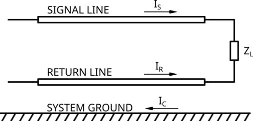

With that analysis out of the way, we can return to a simple model with a ground plane and load impedance (Figure 3).
Two-conductor transmission line feeding a load.
Figure 3. Two-conductor transmission line feeding a load.
The signal current is IS, and the return current is IR. Note that signal and return currents are going in the same direction.
I'll give away the plot here: we're going to define IS and IR in terms of common-mode and differential-mode currents. The differential-mode current is split equally between the signal and return lines. The common-mode current is split unequally between them, with a fraction (h) of the common-mode current traveling along the signal line:
$$\begin{align} & I_{S}~=~ I_{dm} ~+~ hI_{cm} \\[.5em] & I_{R} ~=~ -I_{dm} ~+~(1~-~h)I_{cm} \end{align}$$
Equation 8.
Deriving the Common-Mode Current
To show how we derived Equation 8, let's take the common-mode current at a position z along the transmission lines to be Icm = IS + IR. In a purely differential system, IS = –IR, producing Icm = 0.
In Figure 3, the current at the end of the signal line must be equal and opposite to the current at the end of the return line. The only path for the current is through the load. Therefore, there can be no common-mode current.
However, if there is any amount of capacitive coupling between the signal and return lines and system ground, then we have an alternate path for the common-mode current. Plus, if the signal and return lines are electrically long, then we can get standing current waves on the two conductors. The common-mode current is zero at the load, but non-zero elsewhere along the length of the conductors. These standing current waves tend to radiate very well.

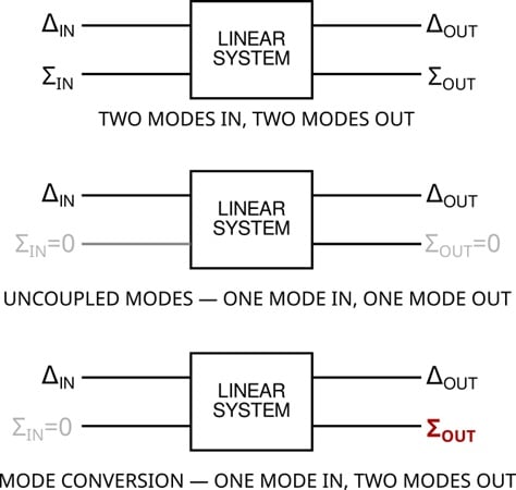

You may recall the term mode conversion from that discussion. We can define mode conversion as the conversion of a differential-mode input into a common-mode output, or vice versa. In the coax twin-lead example, a common-mode current was excited by a differential-mode current. Figure 4 provides an illustration of this concept.
Mode conversion is a property of modal systems where exciting one mode causes an output in some other mode.
Figure 4. Mode conversion is a property of modal systems where exciting one mode causes an output in some other mode.
This phenomenon is worthy of our attention. Given a four-terminal network, applying a differential-mode input to the network will generally result in both differential and common-mode outputs. The relationship is usually reciprocal, so that common-mode signals induced into the system will be converted into differential-mode outputs. Unfortunately, turning common mode into differential mode threatens that desirable property, noise tolerance, of purely differential and balanced systems.
