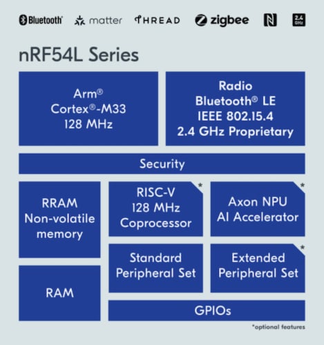

Block diagram of the nRF54L
Block diagram of the nRF54L.
By pushing heavy AI processing onto Axon, the main Cortex-M33 processor is freed up to focus on control logic, wireless communication, and I/O tasks rather than managing inference. The NPU also includes 2 MB of nonvolatile memory and 512 KB of RAM, providing enough space for larger AI models and working data to help keep the system responsive by reducing competition for memory and processing resources during operation.
