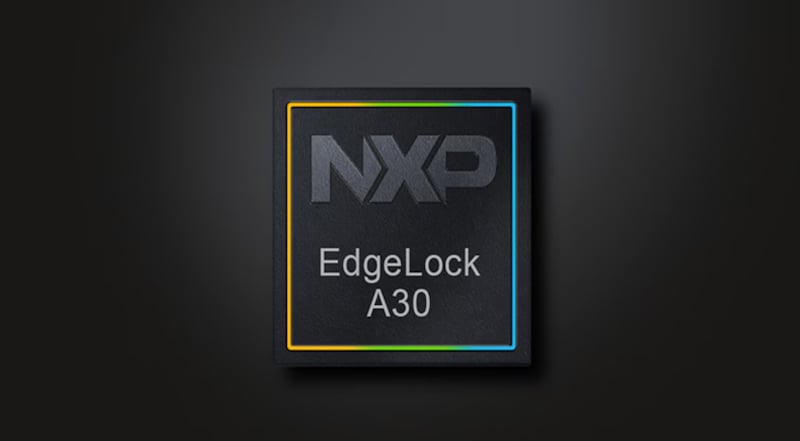

NXP Semiconductors has announced the EdgeLock A30 Secure Authenticator as an easy-to-implement solution for device authentication. The device is based on a RISC-V core and offers a slew of features and certifications that make it simple to integrate into new designs.
EdgeLock A30

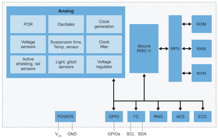

EdgeLock A30 block diagram
The EdgeLock A30 packs a high number of features, including an I2C interface, secure RISC-V core, and cryptographic hardware for key management and storage. Image used courtesy of NXP
Despite its size, the EdgeLock A30 packs in a surprising number of features. The device supports asymmetric authentication, key management and provisioning, and multiple encryption methods, including SHA-256 and AES-128. Furthermore, the chips include a secure RISC-V core and 16 kB of nonvolatile memory, allowing ample space for certificate storage.

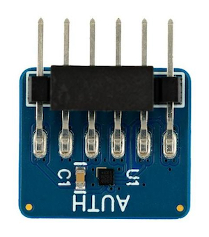

EdgeLock A30 evaluation board
The EdgeLock A30 evaluation board highlights the small size of the authenticator chip. Image used courtesy of NXP
The EdgeLock A30 is available now from NXP, alongside an evaluation board that highlights the size of the authenticator chip.
