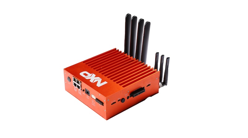

NXP recently released OrangeBox 2.0: a second-generation automotive connectivity domain controller development platform. Designed to centralize and secure the data flow between a vehicle’s gateway and its wired and wireless interfaces, OrangeBox 2.0 introduces new AI and post-quantum cryptography features to facilitate secure communications within the vehicle.
OrangeBox 2.0
OrangeBox 2.0 connectivity domain controller.

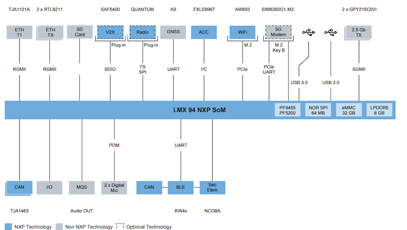

OrangeBox 2.0 leverages the i.MX 94 applications processor that integrates four Cortex-A55 cores, two Cortex-M7 cores, and two Cortex-M33 cores. It also includes an eIQ Neutron neural processing unit to accelerate AI-driven anomaly detection and firewall operations. With this architecture, NXP claims that the platform features a fourfold increase in CPU performance over its predecessor.
OrangeBox 2.0 technology
OrangeBox 2.0 technology.
For memory, OrangeBox 2.0 integrates 6 GB of LPDDR5 memory, 32 GB of eMMC storage, and 64 MB of serial NOR flash. It connects to peripherals through high-speed interfaces including PCIe, USB 3.0, SDIO, and M.2, and supports over-the-air software updates and region-specific adaptations. The system also consolidates multiple connectivity technologies, such as dual-band Wi-Fi 6E, Bluetooth 5.4, BLE/UWB secure access, GNSS, DSRC V2X, and optional 5G cellular, into a single modular controller. Its networking stack includes two 2.5-Gbps and three 1-Gbps Ethernet ports, as well as dual CAN-FD interfaces.
To fortify its post-quantum resilience, OrangeBox 2.0 incorporates NXP’s EdgeLock Secure Enclave and Prime cryptography accelerator, which together support real-time message authentication and cryptographic operations hardened against quantum attacks. A dedicated ASIL B safety island conforms the platform to ISO 26262 requirements for automotive functional safety.
