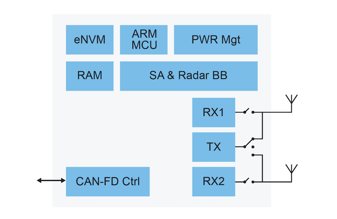

In addition to UWB communication, the NCJ29D6A also includes UWB radar capabilities and an integrated MCU. The addition of radar capabilities, while it may seem redundant at first glance, enables several new applications that can simplify the vehicle’s BOM and enable new features.
The NCJ29D family includes multiple receiver chains for advanced radar/communications signal processing, and all supporting hardware to allow designers to design UWB systems.
