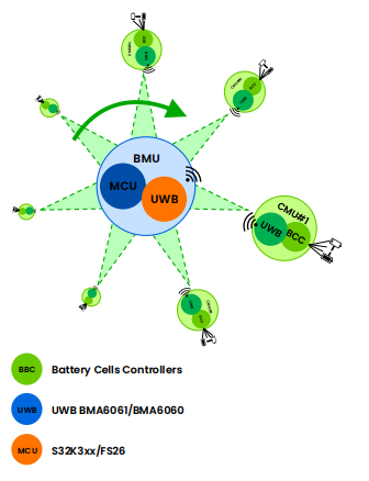

Block diagram battery pack with wireless inter-module communication
Block diagram of a battery pack with wireless inter-module communication.

In a UWB-enabled BMS, data from individual battery cells—such as voltage, temperature, and state of charge—is transmitted wirelessly to the battery management unit (BMU). This eliminates the need for physical wiring harnesses, connectors, and intricate manual assembly processes. Removing these components increases energy density and enables more compact and efficient battery designs, extending electric vehicles (EVs) ranges.
UWB offers other advantages over conventional BMS solutions, too. It simplifies mechanical and electrical integration, which accelerates design cycles and reduces engineering complexity. The wireless architecture decreases labor costs, enhances safety in high-voltage environments, and improves serviceability during maintenance. Additionally, the technology supports scalable and reusable designs, allowing manufacturers to adapt a single architecture across multiple platforms.
