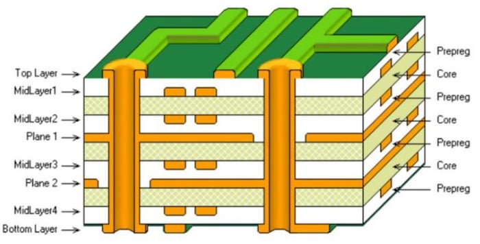

Example layout of a multilayer PCB
Example layout of a multilayer PCB. Image used courtesy of Elecrow
This 124-layer configuration could open new doors in AI semiconductor testing, where wafer-level inspection of stacked HBM modules demands precise, high-speed signal integrity. Each additional layer adds routing capacity and shielding potential. In AI servers, OKI’s high-layer boards support integrated ground planes and microvia arrays that minimize crosstalk and signal loss while improving thermal dissipation. Such capabilities would make the technology a compelling fit for aerospace and defense applications as well. With symmetrical stackups and MIL-STD-883G reliability under 1,000+ thermal cycles, these PCBs are theoretically engineered to withstand environmental extremes while preserving electrical integrity.
