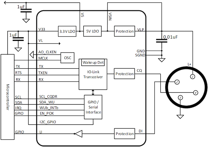

OS2000 block diagram and application circuit
OS2000 block diagram and application circuit. Image used courtesy of Orca Semiconductor
Built to accommodate challenging industrial environments, the OS2000’s 2.5 mm x 2.0 mm WL-CSP-20 package integrates two linear voltage regulators, a digital input channel, an onboard clock generator, and surge protection. These features collectively minimize the need for external components, allowing the OS2000 to fit within space-constrained applications while maintaining a stable 24-V power input range across 8 V to 36 V.
Unlike competing devices that require additional external components to manage power and interface controls, the OS2000’s built-in voltage regulators (3.3 V and 5 V), I2C-controlled driver current settings, and an optional clock output for timing compliance contribute to its compact form factor and simple installation.
Further, the OS2000’s capacity to serve both IO-Link master and device configurations enhances its adaptability to varying industrial setups. Compared to Analog Devices' popular MAX22515, which Orca aims to replace in many applications, the OS2000 reportedly offers a more integrated architecture, reduced footprint, and decreased power dissipation requirements.

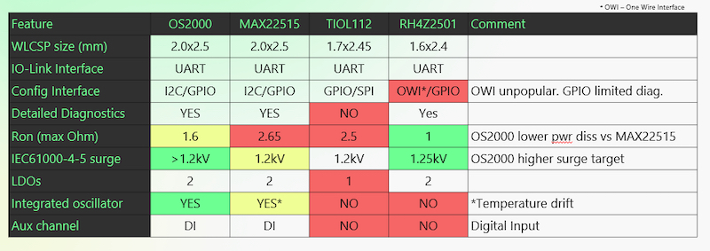

OS2000 competitive analysis
OS2000 competitive analysis. Image used courtesy of Orca Semiconductor
In terms of specifications, the device’s driver current can be set at 50 mA, 100 mA, 200 mA, or 250 mA. Through the I2C control interface, users can adjust the driver’s slew rate with fine-tuned control over signal characteristics. This level of control also minimizes unnecessary power consumption. Orca’s internal oscillator design is another notable addition, offering five output frequencies and allowing the device to serve as a system clock for microcontrollers.
