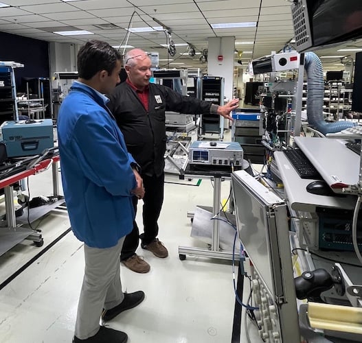

All About Circuit contributor Jake Hertz (left) and Tektronix’s Jeff Schuh (right) inspect a test station on the Tektronix manufacturing floor.

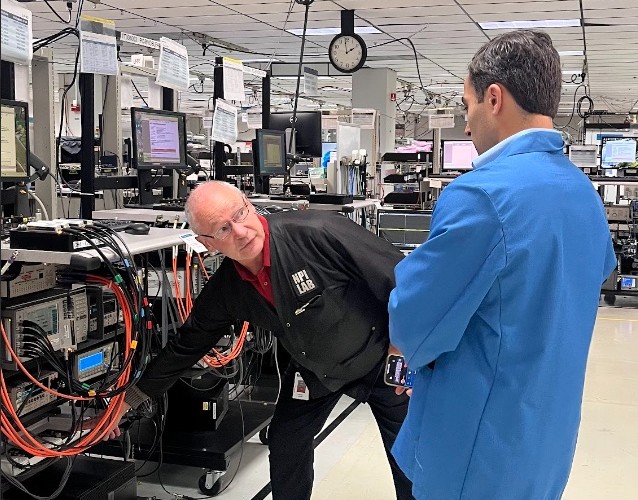

Jake Hertz (left) and Jeff Schuh (right) walking through test results on the Tektronix manufacturing floor.

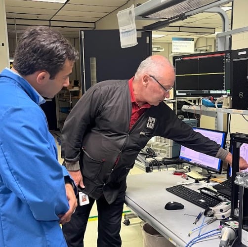

Tektronix’s Jeff Schuch explains a testing station on the manufacturing floor.
Tektronix’s Jeff Schuh explains a testing station on the manufacturing floor.
