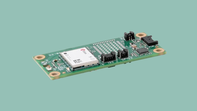

Syslogic has introduced a GNSS expansion board to add high-accuracy positioning to its rugged embedded computers, targeting mobile and outdoor systems that demand repeatable navigation accuracy. Built around U-blox’s X20 receiver platform and available in single- and dual-receiver configurations, the board enables developers to combine RTK-class positioning with GNSS-based heading on a single module.
Syslogic’s all-band GNSS board
Syslogic’s all-band GNSS board. Image used courtesy of Syslogic
The board is an expansion option for Syslogic’s existing x86 and Nvidia Jetson-based systems, reflecting a growing use case across industrial automation, robotics, construction equipment, and autonomous field machinery. In these environments, the problem isn’t whether GNSS is available, but whether it can deliver consistent performance when antennas are mounted on moving platforms or operating near structures, foliage, and earthworks.

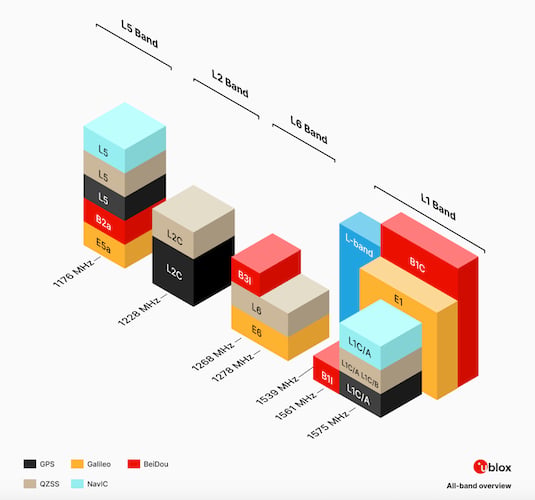

U-blox’s ZED-X20P all-band GNSS receiver powers this board, thanks to its support for modernized signals across the major global constellations. According to Syslogic, the board tracks GPS L1C/A, L2C, and L5; Galileo E1, E5a, and E6; BeiDou B1I, B1C, B2a, and B3I; QZSS including L6; NavIC L5; and SBAS on L1.
An all-band overview
An all-band overview. Image used courtesy of U-blox
This level of multi-frequency tracking allows the receiver to better model ionospheric delay and maintain carrier-phase ambiguity resolution, particularly when signals are degraded. This, in practice, improves availability and convergence behavior when the receiver is operating near obstructions or in mixed urban and industrial settings.

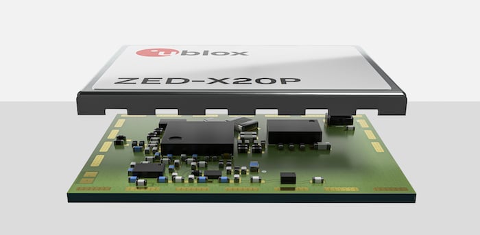

ZED-X20P
ZED-X20P. Image used courtesy of U-blox
This configuration could offer significant advantages for autonomous machines because GNSS-derived heading does not exhibit the same drift characteristics as inertial sensors. It remains usable when vehicle speed is insufficient for reliable course-over-ground estimates. Integrating both receivers onto a single expansion board simplifies wiring and reduces the need for additional GNSS hardware, while still allowing the primary receiver to operate in RTK or PPP-RTK modes.
