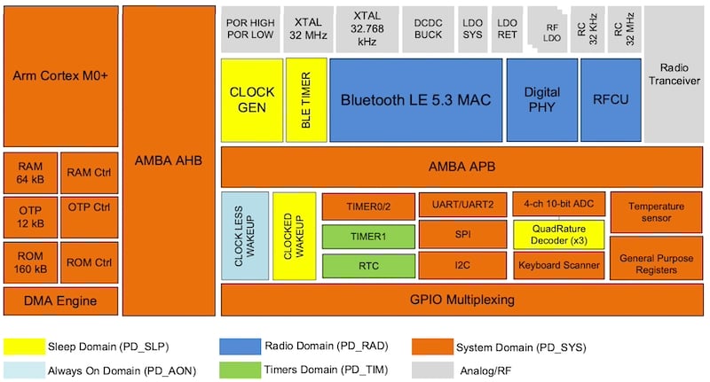

Block diagram of the DA14533
Block diagram of the DA14533.
What does this mean in practice? Fewer external components. The DA14533 only needs six supporting parts to function, which slashes the bill of materials (BOM), simplifies PCB design, and speeds up the time to market. Developers no longer have to cobble together multiple chips to get Bluetooth, processing, and memory in one system. With its ultra-low-power modes, drawing as little as 500 nA during hibernation, this chip has been specifically designed for battery-sensitive use cases like tire sensors or remote access systems.

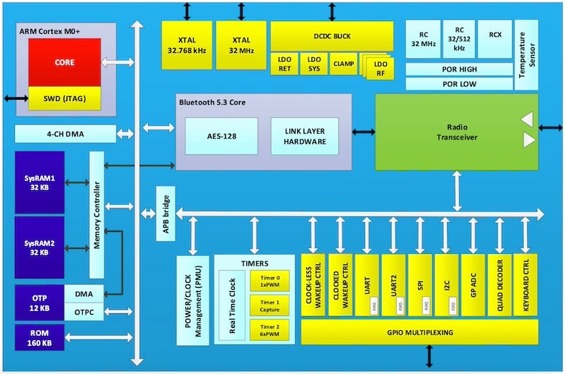

The DA14533's digital power domains
The DA14533's digital power domains.
Its onboard DC-DC buck converter actively adjusts voltage output based on load, further reducing energy waste. That kind of efficiency, paired with a compact design, makes it easier for automakers and industrial designers to build smarter, lower-cost wireless systems in tight spaces.
