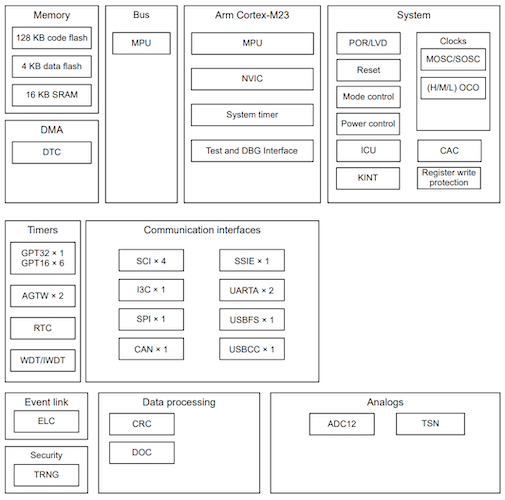

Renesas designed the RA2L2 microcontroller family (datasheet linked) specifically for embedded applications where board space, energy efficiency, and cost all play a critical role. With an active mode power consumption of 87.5 µA/MHz and software standby current as low as 250 nA, these devices deliver long-lasting performance without compromising on features or speed.
Block diagram of the RA2L2 microcontroller
Block diagram of the RA2L2 microcontroller.
The integrated low-power UART has its own clock domain, allowing it to wake the system upon data reception. This feature makes the RA2L2 particularly valuable for wireless peripherals, enabling seamless communication with Wi-Fi and Bluetooth modules while conserving energy.

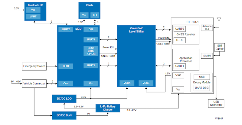

Automotive and Transit Systems
The RA2L2 enables compact and efficient tolling devices. These systems can track vehicle location using GNSS and handle road pricing calculations while operating in mixed toll booth environments.
Block diagram for automotive tracking and toll charging events
Block diagram for automotive tracking and toll charging events.

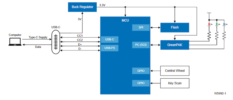

Consumer Electronics
RA2L2 powers energy-conscious gaming keyboards and mice. These peripherals can operate in both wired and wireless modes, offering programmable lighting, fast USB-C charging, and low-latency performance for gamers or productivity users on the go.
Block diagram for an energy-efficient wireless gaming keyboard
Block diagram for an energy-efficient wireless gaming keyboard.
