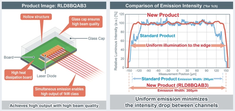

The RLD8BQAB3 (datasheet linked) is an eight-channel laser diode array in a 5.6 mm × 3.3 mm SMD package. Rohm claims that this form factor reduces size by 33% over conventional four-channel diodes from competitors. Each channel features a 300 × 10 μm emission area wired to a common cathode.
Its irradiation method allows it to adapt to different needs. It can perform individual emissions to simultaneous emissions. With a 125 W peak power in each channel, the combined simultaneous emission of all eight channels allows the diode to achieve a total output of 1 kW, an output class Rohm claims is industry-leading for its size.
Rohm’s new laser diode
Rohm’s new laser diode comes in a new SMD form factor while maintaining the uniform profile and other features from Rohm’s conventional diodes.
The RLD8BQAB3 has similar key features found in Rohm’s other laser diodes. It provides a more uniform emission profile across its beam width than standard products. Its wavelength-temperature dependence is at an average of 0.10 nm/°C compared to standard products' 0.26 to 0.28 nm/°C. When operating in the practical temperature ranges of -20°C to 85°C, the RLD8BQAB3 results in a ⊿9.0 nm shift. It has a narrow bandpass filter that reduces sunlight and other ambient light effects. These all contribute to better long-distance detection and higher definition LiDAR.

Laser diodes tend to be built with an emitting surface to encapsulate the diode itself from its environment. For the RLD8BQAB3, Rohm introduced a clear glass cap that serves as the device’s emitting surface. Rohm says this is an industry first for surface-mount laser diodes. The glass cap leads to better beam quality than typical resin surfaces.
Glass cap
The RLD8BQAB3 incorporates a clear glass cap instead of a surface resin, which reduces the effects of scratches caused during dicing.
Scratches often appear when dicing components during the semiconductor fabrication process. These scratches mean that the emitting surface is no longer uniform and can cause light scattering, decreasing the quality of the diode beam. The clear glass cap, Rohm claims, is less affected by light scattering caused by scratches.
