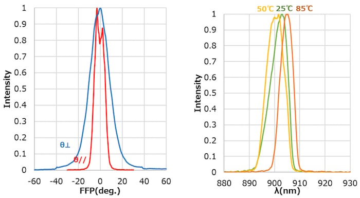

Optical characteristics of the 90QZW800X-E
Optical characteristics of the 90QZW800X-E.
Other noteworthy performance metrics include a max optical output power of 145 W at a forward current (If) of 38 A. It also has a peak pulse wavelength of 915 nm, an operating voltage of 13 V (typ), and beam divergence measurements of 11 def and 20 degrees measured parallel and perpendicular to the beam,​​ respectively.

According to Rohm, high-power laser diodes perform better than conventional laser diodes, in part because they are not as dependent on wavelength temperature. Rohm's RLD90QZW8 model, for instance, has achieved a temperature dependence of less than 0.10 nm/°C. This improvement enables system designs to have a narrower wavelength range, which in turn enhances signal-to-noise ratios and provides more accurate measurements at greater distances. Such advancements in temperature stability contribute significantly to the performance and reliability of LiDAR systems.
