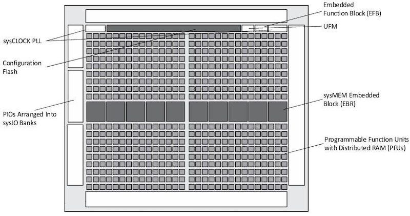

MachXO4 LFMXO4-050 architecture top view
MachXO4 LFMXO4-050 architecture top view. (Datasheet pg. 13)
Latttice optimized the FPGAs for low power consumption and implementation flexibility; they power on and are ready to run within milliseconds using NVM-based fabric. They support optional dual-boot capability with external SPI memory. The family supports field-upgradeable logic, while I/Os maintain system state via TransFR reconfiguration. Flash download times range from 1.9 ms to 5.3 ms, depending on LUT count. The device operates at either 1.2 V or 2.5 V/3.3 V and is backed by a 20-year supply chain support promise.
