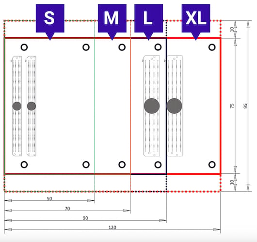

oHFM is designed in two physical variants—oHFM.c and oHFM.s—which share the same philosophy.
The first, oHFM.c, is a connector-based module for high-performance designs and development use. It uses up to four high-density, board-to-board connectors and is designed to support large FPGAs and SoC-FPGAs with extensive I/O and transceiver requirements. According to the specification, there are eight form factors in this family, ranging from 75 mm x 50 mm up to 75 mm x 120 mm, with extended-length options for additional PCB area.
Diagram of oHFM.c, the connector-based variant
Diagram of oHFM.c, the connector-based variant.
The smaller oHFM.c modules support high-speed lanes up to 64-Gbps PAM4 per lane, while the larger-sized variants are specified for up to 112-Gbps PAM4 per lane. Power is primarily delivered through a 12-V input, with a headline maximum current of 32 A along with management and backup rails.

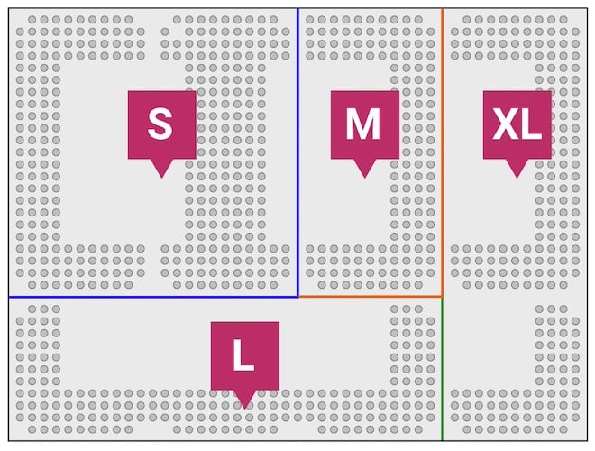

The second variant, oHFM.s, is a solderable module intended for cost-sensitive or space-constrained products. These modules are permanently attached to the carrier PCB and target applications that require features such as vibration and tamper resistance or simplified manufacturing. While oHFM.s modules expose fewer resources than oHFM.c, they follow the same interface rules, enabling designs to move between soldered and connector-based implementations with minimal architectural change.
oHFM.s
Depiction of oHFM.s, the solderable variant.
