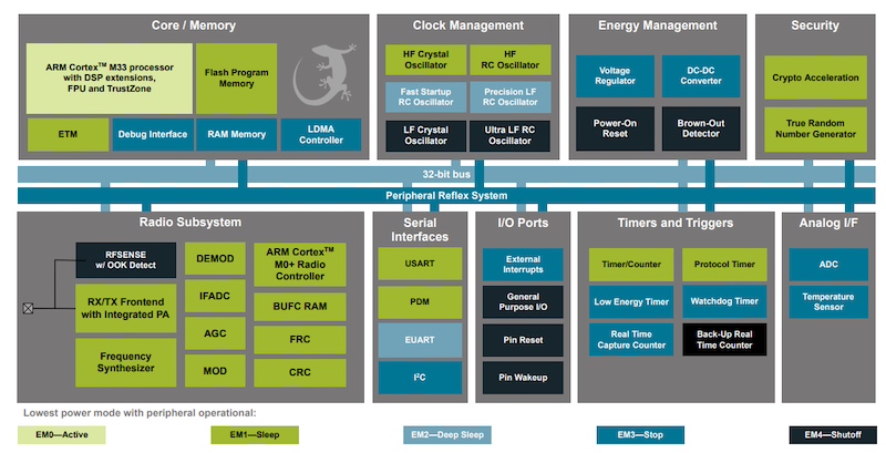

Silicon Labs designed the EFR32BG22L Wireless Gecko family of SoCs for low-cost, low-energy applications. The single-die solution combines a 38.4-MHz Cortex-M33 processor with a 2.4-GHz radio. Depending on the specific model number, it can have up to 352 KB of Flash and 24 KB of RAM. All model numbers are packaged in a 4 mm x 4 mm QFN package. To reduce overall energy consumption, the chip supports several operating modes, with each mode activating specific parts of the chip.
Block diagram of EFR32BG22L SoC
Block diagram of EFR32BG22L SoC.
The Cortex M33 processor is only on in “EM0–Active” mode. When the chip is in other states, such as “EM1–Sleep” and “EM2–Deep Sleep,” only certain parts of the chip remain on, such as the Arm Cortex M0+ Radio Controller in sleep mode and the I2C interface in deep sleep mode. Silicon Labs claims that the BG22L leverages these low-power modes to enable a ten-year battery life. An integrated precision low-frequency RC oscillator (PLFRCO) also eliminates the need for an external oscillator.

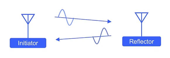

While the EFR32BG24L (BG24L) is also optimized for low-cost, low-energy applications, it includes features not present in the BG22L chip. For starters, the TX supports more protocols, including Bluetooth Low Energy (Bluetooth LE), Bluetooth Mesh, a proprietary 2.4-GHz protocol, and channel sounding. Channel sounding is a technology that estimates the distance between two Bluetooth devices using two techniques—one based on round-trip time (RTT) and the other based on phase-based ranging (PBR).

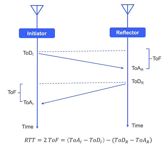

Round-trip time channel sounding
Round-trip time channel sounding.
As its name implies, the RTT technique uses the total time of a transmitted and reflected signal to determine the distance between the initiator and reflector. PBR, on the other hand, uses the delta in phase of the transmitted and reflected signal to determine the total distance. Due to the complexity of measuring and analyzing phase-based information, Silicon Labs says PBR is a highly secure technology.
