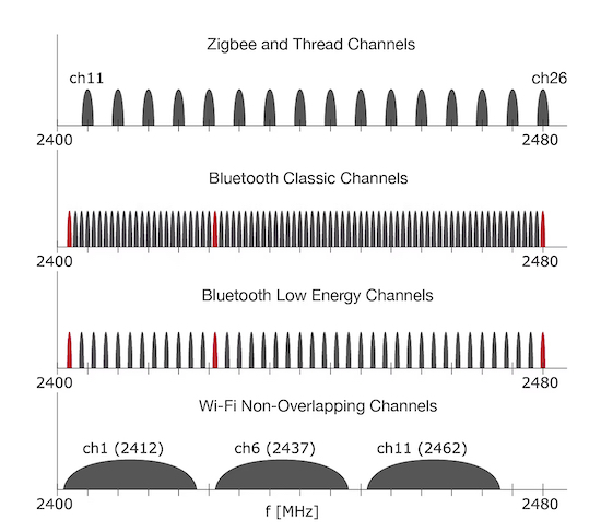

Coexistence Interfaces and Timing for Multiprotocol IoT
The demand for multiprotocol solutions in IoT and industrial automation is driven by the growing complexity and density of connected devices. IoT ecosystems now routinely involve the simultaneous use of Bluetooth, Zigbee, Thread, and Matter, each serving distinct purposes. For example, Bluetooth Low Energy (BLE) excels in device-to-device communication with low latency, while IEEE 802.15.4-based protocols like Zigbee and Thread provide robust mesh networking for applications requiring high reliability.
One major technical challenge is managing coexistence in the crowded 2.4-GHz band, which is used by most IoT protocols alongside Wi-Fi. Without robust coexistence mechanisms, interference degrades performance, causing packet loss or increased latency. Advanced dual-radio systems, such as the SYN20708, address this by implementing hardware-level coexistence interfaces and precise timing control to mitigate interference.
Many IoT protocols overlap in the frequency domain
Many IoT protocols overlap in the frequency domain. Image used courtesy of Silicon Labs
Coexistence interfaces, such as Synaptics' Serial Enhanced Coexistence Interface (SECI), use real-time signaling between radios, allowing them to share information about upcoming transmissions. For example, a Bluetooth radio can signal a Zigbee radio when it needs priority access, avoiding overlapping transmissions. These interfaces often include priority levels and arbitration mechanisms enabling high-priority tasks, such as Bluetooth audio streaming, to preempt lower-priority operations like Zigbee network updates.
Precise timing control works in tandem by ensuring transmission and reception events are scheduled without overlap. In dual-radio systems like the SYN20708, this involves tight synchronization of the two 2.4-GHz radios. The system leverages low-latency processing to determine precise time slots for each protocol's activities. For instance, the hardware allocates microsecond-level time slices, preventing concurrent radioactivity that could cause interference. Additionally, timing protocols such as adaptive frequency hopping (AFH) in Bluetooth help avoid occupied channels by dynamically steering transmissions to clearer frequencies.
