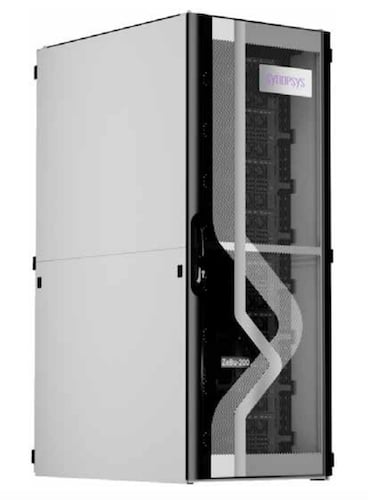

The ZeBu-200
The ZeBu-200.
Along with a newly introduced ModelerHAV methodology, the ZeBu architecture increases scalability and support for larger design capacities than previous generations—up to 15.4 BG. By leveraging Synopsys' interface IP expertise, ZeBu-200 allows designers to partition multi-die or large AI workloads efficiently to simulate tens of billions of gates.
Synopsys says the ZeBu-200 improves debugging efficiency and reduces turnaround time for verification cycles with its unlimited waveform capture capabilities and interactive waveform reconstruction through the Synopsys Verdi debug environment. The system uses integrated multi-threaded simulation with virtualization to significantly accelerate software bring-up. It also accesses a broad ecosystem of transactor models, memory models, virtual system adaptors, and speed adaptors, facilitating flexible emulation across diverse applications.

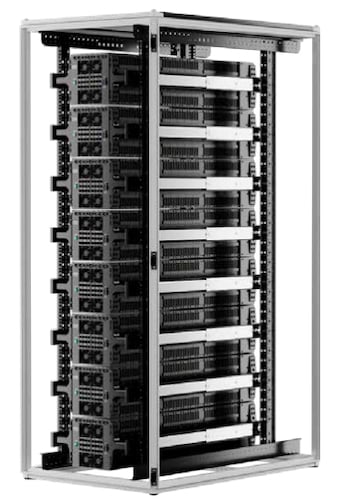

The HAPS-200 solution
The HAPS-200 solution.
The HAPS-200 supports high-speed connectivity options, including QSFP, LVDS, MGB, USB3, and HT3 for integration with a variety of verification environments, and its rack-mountable design maximizes space efficiency through a vertical PCB placement with side-mounted connectors. The system consumes up to 2 kW of power and requires a 220-V supply.
For the workflow, the HAPS-200 supports the HAPS ProtoCompiler software, which integrates directly with the Verdi debug environment and uses a timing-driven synthesis engine to optimize FPGA partitioning and connectivity through the HapsTrak3 cabling system. The system supports multi-user and multi-design parallelization so teams can validate different design iterations simultaneously. When integrated with the ZeBu-200 synchronous clocking system, HAPS-200 offers emulation solutions for software bring-up, RTL regression, and power-performance analysis.
