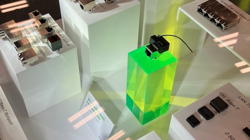

At Embedded World North America last week, Taoglas introduced the FXM100, the industry's first Wi-Fi antenna designed specifically for mounting on an RJ45 jack.

“Ant Jack” Saves Space, Mounting on an RJ45 Jack
Measuring 26.65 x 15.65 x 13.1 mm and weighing only 2 grams, the FXM100—also called “AntJack”— is a space-efficient solution for devices requiring compact but reliable wireless capabilities. The antenna is built on a flexible PCB pre-attached to a lightweight plastic carrier for easy integration with an RJ45 jack. It comes equipped with a 60-mm coaxial cable with a diameter of 1.37 mm, terminating in an I-PEX MHF I (U.FL-compatible) connector.
Close-up image of the FXM100
Close-up image of the FXM100 at Embedded World North America.

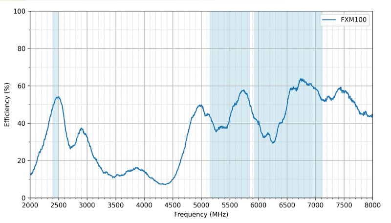

FMX100 efficiency versus frequency
FMX100 efficiency versus frequency. Image used courtesy of Taoglas
