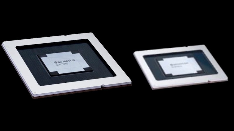

Tomahawk 6-100G (left). Tomahawk 6-200G (right)
The Tomahawk 6 builds on its predecessor’s foundation (in other words, the Tomahawk 5’s 51.2 Tbps) and incorporates new capabilities tailored for AI-driven communication patterns. Central to this evolution is support for both 100G and 200G PAM4 SerDes, including options for 1,024 100G lanes or 512 200G lanes, with electrically pluggable and co-packaged optics available. Such flexibility enables system architects to tune interconnect configurations for both legacy infrastructure and cutting-edge optical topologies without changing core silicon.

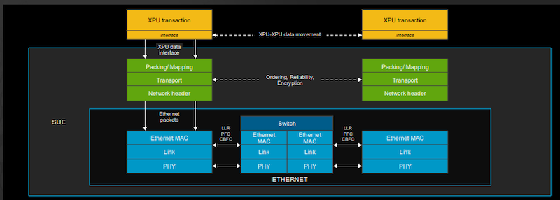

Broadcom explicitly designed the Tomahawk 6 to address the diverging demands of scale-up and scale-out networks in AI infrastructure. Scale-up interconnects link XPUs within a tightly coupled compute node to facilitate high-throughput memory access and low-latency model parallelism. To this end, Tomahawk 6 enables single-hop connectivity for up to 512 XPUs in a scale-up domain, more than seven times the scale achievable with existing solutions.
By integrating Broadcom’s Scale-Up Ethernet (SUE) framework, the chip supports memory-semantic communication across XPUs over standard Ethernet, reducing dependency on proprietary interconnects like NVLink. On the design rationale behind Tomahawk 6’s scale-up support, Del Vecchio explains, “With Tomahawk 6, you can scale up to 512 GPUs or XPUs... you want to have a single hop, just a single switch hop for latency reasons and also for just communication and congestion management.”
Tomahawk 6 supports open Scale-Up Ethernet.

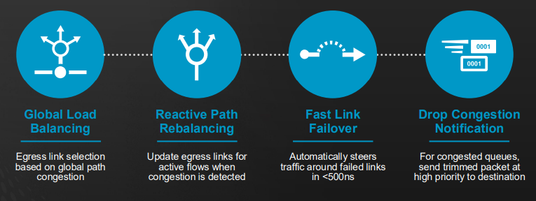

Traditional data center switches often operate below 70% utilization to mitigate congestion and minimize tail latency. AI networks, however, must drive fabric utilization beyond 90% to meet the demands of large-scale model training and inference. To sustain performance at such intensities, Tomahawk 6 incorporates Cognitive Routing 2.0, Broadcom’s next-generation adaptive routing and telemetry suite.
The switch uses network-wide intelligence to dynamically rebalance traffic based on real-time congestion metrics. Compared to static equal-cost multipath (ECMP) routing or hash-based schemes, Tomahawk 6 performs egress link selection with global visibility into path congestion. In practice, this results in up to 50% higher throughput under load and response times to link failures that are 10,000 times faster than standard Ethernet failover mechanisms. The system steers active flows away from degraded paths and can trim and retransmit congested packets to maintain performance without stalling.
Broadcom Cognitive Routing 2.0.
Cognitive Routing 2.0 also includes enhanced support for arbitrary topologies, including Clos, torus, rail-optimized, and scale-up domains. It incorporates real-time physical link monitoring that unlocks predictive maintenance by identifying degrading optical or copper channels before failure occurs.
