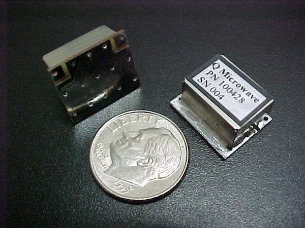

Figure 2. Miniature RF filter.
Figure 2. Miniature RF filter. Image used courtesy of Q Microwave
Performance Implications of Miniaturization
Reducing the physical size of a microwave filter changes its electrical behavior in several ways. Although the specific effects depend on the miniaturization technique, the following performance trade-offs are common in compact filter designs:
  • Smaller resonators can concentrate current and electric fields in tighter regions. This can increase conductor and dielectric losses and lower the quality factor. A lower quality factor broadens the resonances and reduces selectivity, making the filter's frequency response less sharp.
  • Small fabrication variations have a bigger effect on coupling strength in small structures. A slight change in conductor width, for instance, can produce larger deviations from the designed passband and distort the intended response.
  • Compact structures can introduce parasitic resonances or higher-order modes that can create unwanted peaks or dips near the passband.
  • Higher current density and stronger electric fields increase the risk of thermal effects, nonlinear behavior, and, at sufficiently high power levels, physical failure.

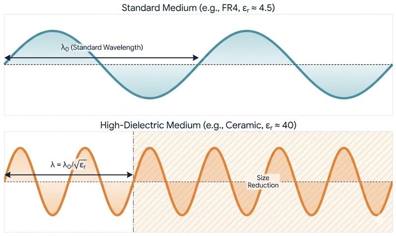

Select a substrate with a higher relative permittivity (εr) to reduce your resonator's physical dimensions while maintaining the target frequency. Your guided wavelength decreases according to:
$$\lambda_g \approx \frac{\lambda_0}{\sqrt{\epsilon_{eff}}}$$
Equation 3
A higher effective dielectric constant generally means you need less physical length for a given electrical length (Figure 3). This allows your resonator to occupy a smaller footprint.
Figure 3. Increasing dielectric constant for wavelength compression.
Figure 3. Increasing dielectric constant for wavelength compression. Image used courtesy of Q Microwave
When applying this approach, compare your materials based on their loss tangent (tan δ), thermal stability, and dielectric constant tolerance. A lower loss tangent can help you minimize dielectric losses, while good thermal stability can help you maintain your filter's performance consistently as temperature changes.
The dielectric constant tolerance is also important because variations in εr can shift your resonant frequency and affect coupling, especially in a compact design.
For narrowband or high-Q filters, you may need tighter fabrication tolerances because small dimensional variations can measurably shift your resonant frequency or coupling conditions, particularly as your guided wavelength decreases.
