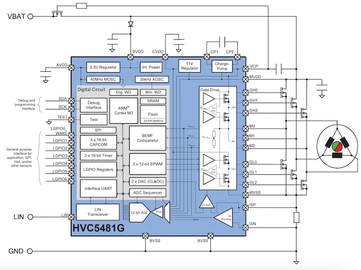

Block diagram of TDK HVC5481G
Block diagram of TDK HVC5481G.
BEMF detection is a method for determining a motor’s position without using physical sensors. As the motor spins, its coils generate a small voltage—the “back EMF”—and the controller uses that signal to time the next phase of commutation. It’s a lightweight, cost-effective method that works well at medium to high speeds. This makes it suitable for applications such as engine cooling fans.
While other HVC 5x chips feature half-bridge drivers for lower-power use cases, the 5481G targets applications that need more muscle and smarter control. It also introduces features like single-shunt field-oriented control (FOC), along with an onboard LIN transceiver to make integration into zonal vehicle networks straightforward.
The HVC5481G contains a digital circuit part of the SoC and a gate-drive part. The digital part comprises, among other things, the Arm Cortex-M3 processor, SPI interface, SRAM (8 KB), Flash (64 KB), EEPROM, and BEMF comparator. The HVC5481G has six gate drive outputs.
