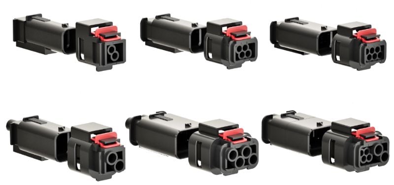

The six connectors in the LVCS standard
The six connectors in the LVCS standard. Image used courtesy of Tesla
Each connector in the LVCS lineup features single-wire sealing and independent secondary locking mechanisms, which ensure durability under variable conditions while minimizing risks of disconnection or environmental contamination. The connectors are compact and maintain the required spacing for safe 48 V operation, with standardized configurations that support both autonomous functions and high-efficiency power distribution.
For ease of identification and assembly, the LVCS is color-coded in a standard light blue. Meanwhile, by consolidating numerous connector types into a smaller, uniform set, this design hopes to reduce manufacturing complexity, cost, and weight associated with traditional connector systems.
