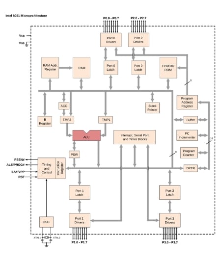

The 8051 used a Harvard architecture, keeping program and data memory in separate address spaces so the CPU could fetch an instruction and access data without contention. Around the 8-bit ALU sat four switchable banks of working registers, which let an interrupt service routine swap its whole register context in a single instruction rather than pushing and popping values one at a time. Five interrupt sources are fed into a two-level priority scheme.
The Intel 8051’s microarchitecture
The Intel 8051’s microarchitecture. Image used courtesy of Appaloosa via Wikimedia Commons (CC BY-SA 3.0)
The feature that set the part apart was its Boolean processor. The 8051 could test, set, and clear individual bits directly, with 210 bit-addressable locations spread across RAM, the register banks, and the I/O ports.
