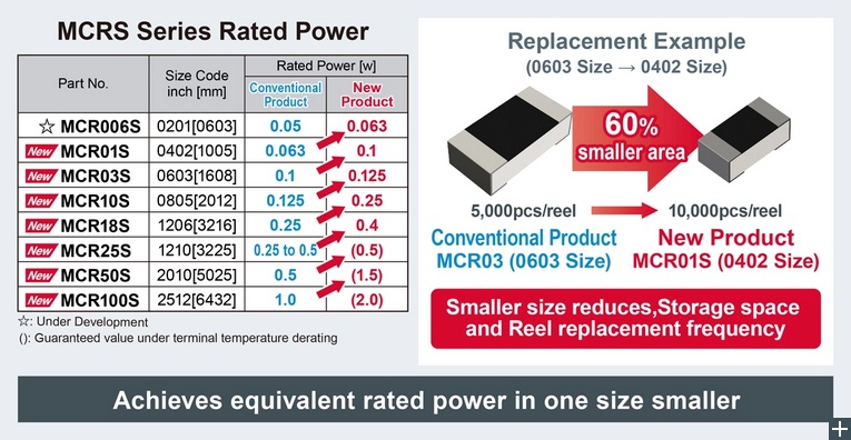

Rohm’s Compact Resistor Family
Rohm Semiconductor recently released its MCRx chip resistor family to support the growing need for miniaturization and higher power density in automotive electronics. These resistors address space constraints in electric vehicles (EVs), ADAS, and other high-density applications by reducing the component size without sacrificing power handling.
The MCRS series reportedly offers up to 50% size reduction while maintaining equivalent power ratings, while the MCRL series provides ultra-low resistance options for high-accuracy current sensing. Rohm claims both variants operate reliably under extreme conditions, including 155°C temperatures and automotive-grade mechanical stresses.
The MCRS series rated power
The MCRS series rated power. Image used courtesy of Rohm Semiconductor
Key specifications include package sizes as small as 1.0 mm × 0.5 mm, power ratings up to 2.0 W, and resistance values from 1 mΩ to 10 mΩ. The resistors meet AEC-Q200 standards, withstand thermal cycling, and maintain stable resistance over time. Applications include battery management, radar/LiDAR modules, and high-power switching circuits.

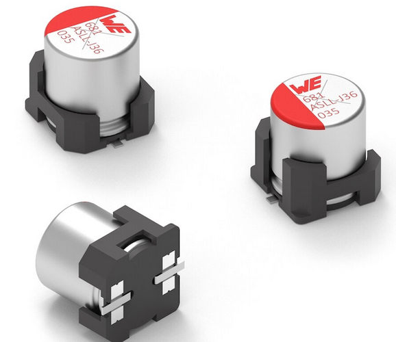

Würth's Vibration-Resistant Capacitors
Würth Elektronik claims its new vibration-resistant capacitors improve the mechanical durability of automotive electronics, addressing issues caused by continuous road vibrations and shocks. These components strengthen PCB bonding through enlarged solder pads, use reinforced base plates to dampen resonant frequencies, and incorporate strategic cutouts to maintain thermal dissipation. Würth says the capacitors can withstand 30-g acceleration forces, exceeding standard automotive vibration requirements by 200%. This may qualify them for engine control units (ECUs), power electronics, and sensor modules.
Würth Elektronik’s WCAL-ASLI vibration-resistant capacitors
Würth Elektronik’s WCAL-ASLI vibration-resistant capacitors. Image used courtesy of Würth Elektronik
The WCAP-ASLI series offers capacitance values from 10 µF to 6,800 µF, voltage ratings up to 63-V DC, and low impedance for stable operation. They comply with IEC 60384-4 and AEC-Q200 standards, ensuring reliability under extreme conditions (-55°C to +105°C) with a 50,000-hour MTBF. Key applications include stabilizing EV powertrains, maintaining signal integrity for in-vehicle networking, and improving ADAS sensor calibration.

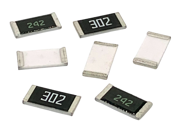

Stackpole's High-Voltage, Thin-Film Resistors
Stackpole Electronics’ RNCV series thin-film resistors provide high-voltage stability and environmental resilience for modern automotive applications, including electric vehicles (EVs) and ADAS. With a low voltage coefficient of resistance (<1.5 ppm/V), these resistors maintain accuracy even at 1,000 V, making them useful for battery management and high-voltage monitoring. Anti-sulfur construction prevents corrosion in harsh environments, while temperature cycling endurance (-55°C to +155°C) ensures long-term reliability in demanding automotive conditions.
Stackpole’s RNCV series thin-film resistors
Stackpole’s RNCV series thin-film resistors. Image used courtesy of Stackpole Electronics
Available in 0805, 1206, and 1210 packages, the RNCV series offers resistance values from 160 kΩ to 3.01 mΩ with tolerances as low as ±0.1%. Their 1,000-V continuous working voltage, 1,400-V surge handling, and <0.05% resistance drift over 1,000 hours meet stringent industry reliability expectations. AEC-Q200 qualification and compliance with automotive vibration and shock standards make these resistors suitable for applications like Li-ion battery voltage sensing, ADAS camera circuits, and high-speed CAN-FD networks.
