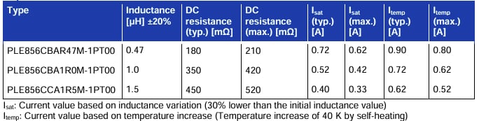

Key specifications for PLE856C Series inductors
Key specifications for PLE856C Series inductors. Image used courtesy of TDK
While inductors often face obstacles to miniaturization, these inductors feature a 40% smaller mounted area and a 50% lower volume over TDK's prior small inductor series.

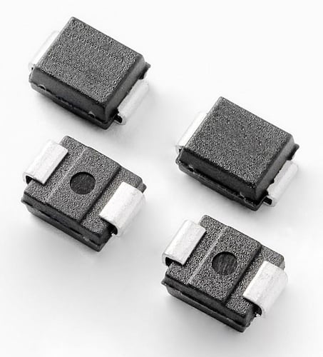

Littelfuse's TPSMB Asymmetrical TVS Diode Series
Littelfuse's TPSMB Asymmetrical TVS Diode Series. Image used courtesy of Littelfuse
As requirements for charging circuits, inverters, and other power systems increase, the supporting and primary active components must also improve. Littelfuse designed its new TPSMB Asymmetrical TVS Diode Series for just that purpose. SiC MOSFETs require clamping circuits between the gate and source for overvoltage and reverse surge protection. In high-power designs (including most SiC circuits), a combination of Zener diodes and TVS diodes protect the MOSFET from both negative and positive surge currents.
An asymmetrical TVS diode combines the functionality of both a Zener diode and a TVS diode in one package. SiC MOSFETs have specific negative and positive gate voltage ratings and requirements. Without an asymmetric part, the gates are protected with a Zener and TVS in series. Combining both into one package reduces parts count and increases the reliability of the circuit design. The asymmetry enables different positive and negative voltage clamping values. The new TVS diodes will be designed into circuits for onboard chargers (OBCs), EV traction inverters, I/O interfaces, and Vcc buses.
