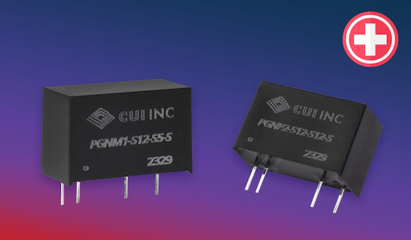

Traco isn't alone in the market of new medical DC-DC converters. Last year, CUI Inc. announced its PGNM-S and PGNP-S series of isolated DC-DC converters, which target medical instruments, consumer electronics, EV charging, and industrial electronics applications.
CUI’s medical-grade converters
CUI’s medical-grade converters. Image used courtesy of CUI Inc.
They offer a very high 6,000 VAC isolation in all four of their 1-W and 2-W SIP converter series. They can also operate in temperature ranges from -40°C to +105°C.

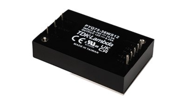

TDK Corporation has introduced its latest offering of 30–75 W-rated TDK-Lambda PYQ series quarter-brick footprint DC-DC converters. The PYQ50 devices feature a 12:1 input range (14–160 VDC), and the PYQ75 offers an 8:1 range (9–75 VDC), making them compatible with many standard system voltages, including 12 V, 24 V, 48 V, 72 V, and 110 VDC.
TDK’s quarter-brick converter
TDK’s quarter-brick converter. Image used courtesy of TDK Corporation
The new series achieves up to 90% efficiency, lowering heat generation and extending operation in various temperature ranges, from -40°C to +105°C (with derating at high temperatures). In addition, they boast 3,000 V input/output isolation to meet high-voltage requirements. Their silicone-potted plastic case enhances resistance to shock and vibration, making them useful for harsh environments.

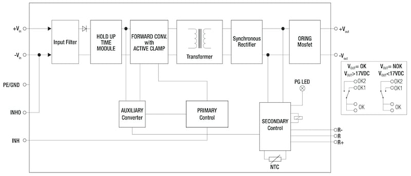

The last spotlight in our roundup comes from Recom, which recently launched the RMD150 and RMD300 series of DC-DC converters. Recom offers these devices in a wide input range of 16.8 V to 137 V continuous and 14.4 V to 154 V short-term—compliant to all common railway standards. The converters come in two power ratings: 150 W (RMD150) and 300 W (RMD300). Both feature 94% efficiency, reducing 40% heat dissipation than other solutions, according to the company.
Block diagram of the RMD150
Block diagram of the RMD150. Image used courtesy of Recom
Both the RMD150 and RMD300 devices are housed in metal casings for better thermal management and IP-20 ingress protection for chassis mounting, enabling natural convection cooling. The DC-DC converters can also operate from -40°C to +70°C. Recom claims the devices can even handle brief excursions to +85°C for 15 minutes at full power without derating.
