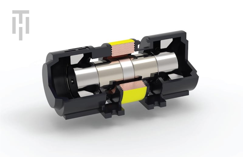

Titan Haptics' Carlton actuator is a double-ended 14 mm x 34 mm linear magnetic ram (LMR) motor that adds high-fidelity impact sensation to common tactile actions. The underlying technology to Titan’s LMR is a wideband voice-coil haptic motor. The motor uses solid-state magnetic suspension rather than springs or flexible attachments. It can mimic a hammer-type action with both a tactile feel and a metallic striking sound for even greater realism.
TacHammer Carlton actuator inside view
TacHammer Carlton actuator inside view.
The sliding magnetic slug can be slammed against an impact disk to create both a sound and a harsh simulated impact shock. Selectable impact surfaces allow developers to create experiences that better match the specific simulated experience. Plastic impact caps will produce a dull sound and softer sensation, while metal impact disks will deliver a metal-on-metal experience.
