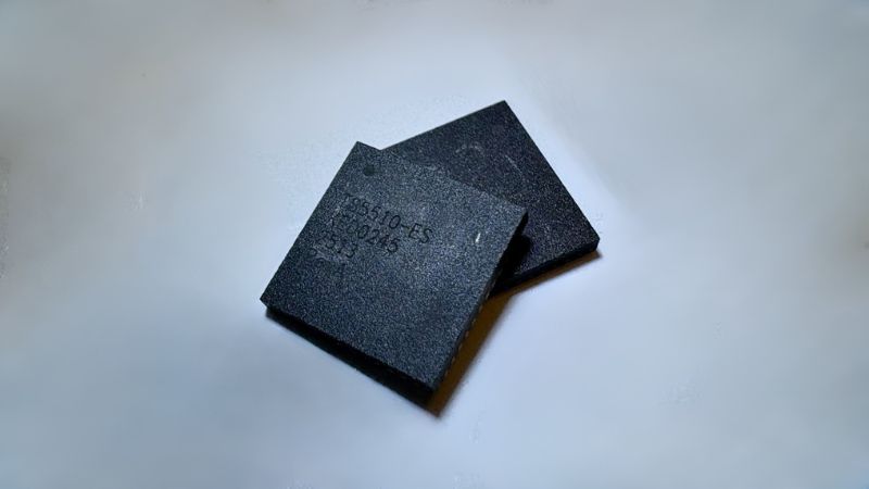

Triad Semiconductor recently announced the TS5510, a two-channel analog front-end (AFE) low-noise programmable-gain input amplifier. The TS5510 audio capture device is designed for both home and professional recording applications.
TS5510
The TS5510.
It can match both high- and low-level inputs to conventional analog-to-digital converters (ADCs) while preserving signal-to-noise ratio (SNR) and offering gain control flexibility. The new part replaces voltage-control with current-control amplification to dramatically expand the dynamic range possible between the two input channels.

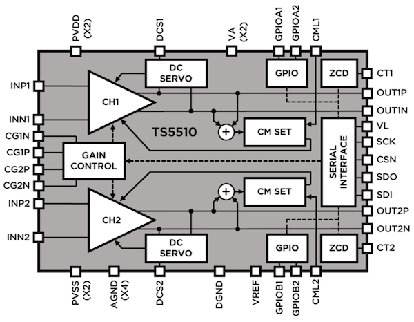

The TS5510 mitigates the issue by utilizing the current conveyor-based architecture. Conventional input sections often utilize op amps, which are voltage amplifiers with voltage feedback. Op amps are subject to clipping at or near their limits. The current conveyor amplifier, in contrast, uses current feedback, allowing much greater bandwidth than a voltage-feedback amplifier. With digital control, the two inputs in each TS5510 can match widely diverse signal levels without external components.
Block diagram of the TS5510
Block diagram of the TS5510.
The current conveyor circuit was invented in 1968 but did not gain widespread use until recently, due to the widespread adoption of voltage-mode amplifiers. However, recent attention to the circuit has brought it into devices like the new TS5510.
Current conveyor circuits exhibit lower delay between input and output, a higher dynamic range, lower power consumption at high frequencies, and lower switching noise. In a voltage-controlled op amp, delay and slew distortion can be reduced by decreasing the voltage swing (reducing the gain), thereby decreasing the charging and discharging times. However, doing so can also decrease the signal-to-noise ratio. Current conveyor circuits have lower parasitic capacitance, so delay can be reduced without increasing noise. The end result is an amplifier with improved noise characteristics, a wider dynamic range, and greater flexibility in the amplification stage.
