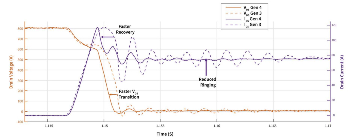

Turn-on waveform comparison
Turn-on waveform comparison between third and fourth generations.
The new MOSFETs also feature optimized body diodes, significantly reducing reverse recovery losses and electromagnetic interference. The devices operate with a 75% lower voltage overshoot during switching events. Wolfspeed also says these devices are more reliable than their third-generation counterparts; they can tolerate junction temperatures up to 200°C and demonstrate up to 100x improved cosmic ray failure-in-time (FIT) rates. Meanwhile, their 2 ms short-circuit withstand time bolsters fault tolerance.

Reverse recovery transients
Reverse recovery transients of generation four versus generation three.
Reverse recovery impacts system noise and EMI. When the reverse recovery charge dissipates rapidly, it can produce voltage overshoot and ringing that result in common-mode noise and radiated EMI. This noise complicates EMI compliance and often necessitates larger, costlier filters or design adjustments.
