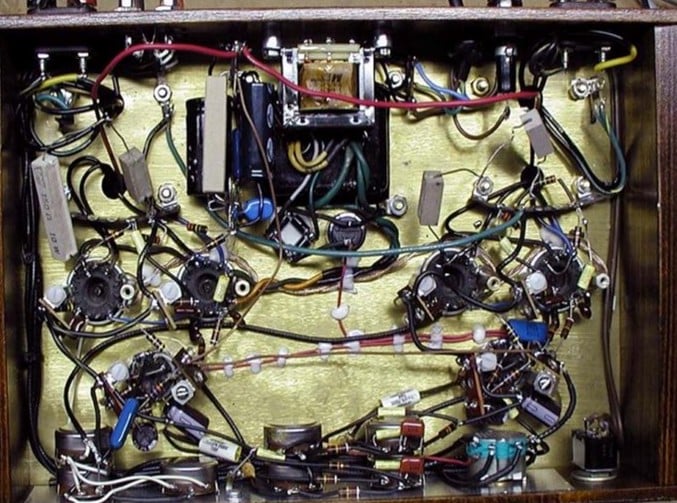

Vintage electronic products like vacuum tube radios and televisions were constructed using bus bars and terminal strips. The bus bars provided the high side and ground voltage rails for the vacuum tube radio and television electronic circuits.
Figure 1 illustrates a vacuum tube audio amplifier electronic circuit constructed using point-to-point wiring. This wiring method was effective for building the electronic circuits.
A vacuum tube audio amplifier constructed using point-to-point wiring
Figure 1. A vacuum tube audio amplifier constructed using point-to-point wiring. Image used courtesy of PS Audio
In addition, the point-to-point wiring of vacuum tube circuits allowed easy changes and replacement of electronic components. The ability to easily build and repair these point-to-point circuits provided educational value and encouraged careers in the electronics industry.

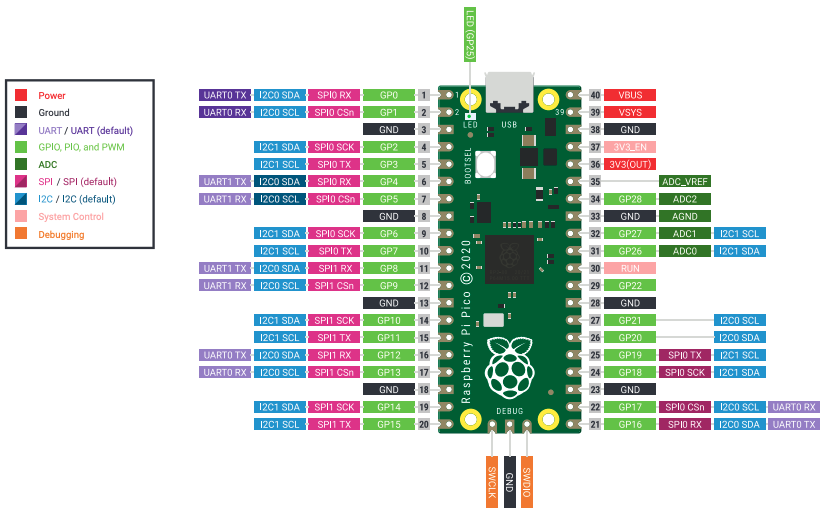

To aid in wiring the PIR sensor and the transistor relay module to the Raspberry Pi Pico, a pinout of the programmable board is provided in Figure 11.
Raspberry Pi Pico pinout
Figure 11. Raspberry Pi Pico pinout. Image used courtesy of the Raspberry Pi
