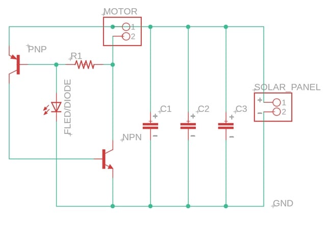

For this project, I chose a variant of Tilden's diode solar engine design. The schematic for the diode solar engine circuit is shown in Figure 4.
Diode solar engine circuit diagram.
Figure 4. Diode solar engine circuit diagram. Image used courtesy of Kristijan Nelkovski
Under direct sunlight, voltage across our circuit's capacitors slowly rises. When it exceeds the diode's threshold voltage, it starts to conduct electricity. At this point, the PNP transistor connected with the diode at its base turns on, applying current to the base of the NPN transistor. This closes the circuit between our motor and the capacitors, thus powering the robot on.
As the NPN collector voltage drops to zero, current through the resistor reverses and activates the PNP transistor, effectively taking the diode out of the circuit. Our robot then runs until the voltage of the capacitor drops and the whole process repeats again.
