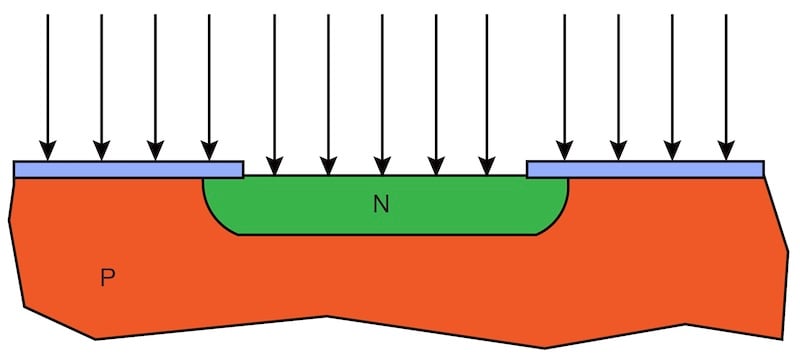

Dopant Diffusion
The wafer is then placed into a furnace—a quartz tube heated to greater than 1,000 °C. A gas carrying the desired dopant (in this case, boron, arsenic, or antimony) swirls around the wafer and slowly diffuses into the surface. This can be seen in Figure 2-13.
A gas containing N-type dopants (boron, arsenic, or antimony) diffuses slowly into the surface of the wafer at high temperatures
Figure 2-13. A gas containing N-type dopants (boron, arsenic, or antimony) diffuses slowly into the surface of the wafer at high temperatures.
Note two important facts here:
  1. Dopants crowd near the surface of the silicon. Over time, they diffuse deeper into the silicon, but there will always be more dopants near the surface. Any diffused region thus has a marked gradient.
  2. Dopants not only diffuse downward but also sideways. Since supply is more limited at the very edge, the sideways diffusion extends to only about half the distance of the downward one. This places the junction (the place where N = P) underneath the oxide, where it’s never exposed to the dirty environment.
