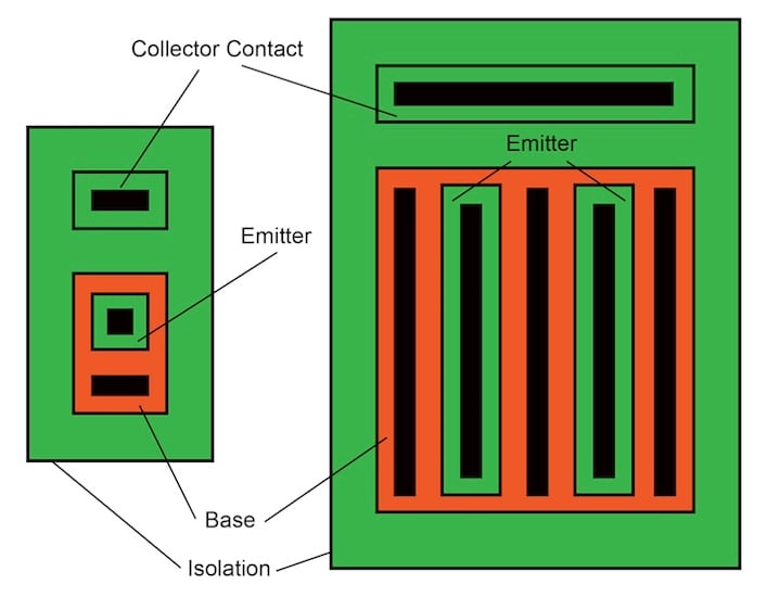

Layout Techniques for Increased BJT Current Capacity
To increase the current capability of a bipolar transistor, you can place base contacts on both sides of the emitter and lengthen the emitter. Figure 2-19 shows the top views of two NPN transistors: a minimum-geometry transistor on the left and a higher-current version on the right.
A minimum-geometry NPN transistor (left) and a higher-current design (right).
Figure 2-19. A minimum-geometry NPN transistor (left) and a higher-current design (right).
To make the life of a designer easier, the isolation pattern is usually drawn as a rectangle and then inverted when making the mask. This means that the isolation diffusion is actually between devices, not in the device area. Many processes require that all contacts be the same size, in which case the contact rectangles must be broken up into small, identical, properly spaced squares.
Be aware that transistors of different sizes, like the ones drawn here, don’t match well. At low current, a large emitter area produces a higher gain than a small one. This is because the minority carriers have a higher chance of being captured by the collector.
If you want to produce a precise ratio, use only one emitter size and identical base contacts. The emitters can be in a common base area, and the collector size is of no consequence except to the collector resistance and saturation voltage.
