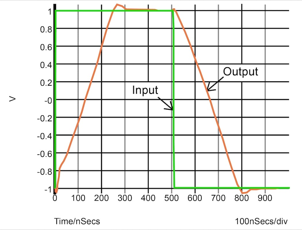

Without resistors in the feedback path, this is a buffer connection with a closed-loop gain of one. With the entire open-loop gain (85 dB) being judged, this is the most severe test for stability. Figure 10-5 shows the input and output waveforms for the buffer connection.
Input pulse and output response for bipolar op amp simulated with asvoltage follower
Figure 10-5. Input (green) and output (orange) waveforms for the op amp buffer connection. [click to enlarge]
The output waveform shows the amplifier to be very stable. There’s no ringing, just a small overshoot.
But the output curve shows something else: rise and fall times are substantial and almost straight lines. This is the slew rate—the time it takes to charge and discharge the 10 pF capacitor (C1 in Figure 10-1) over a 2 V span with the operating current. You can speed it up by increasing the operating current but at the cost of increased power consumption.

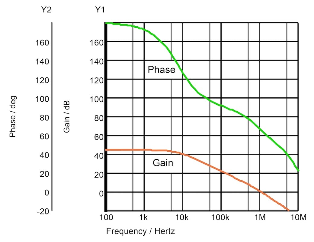

What if, in a specific application, the closed-loop gain is never lower than 40 dB? In such a case, we only have an excess open-loop gain of about 45 dB, which makes compensation considerably easier.
Let's examine this. In Figure 10-6, we have the same circuit as in the loop gain analysis above, except that the feedback resistors are also in the loop.
Circuit schematic for simulating op amp loop gain and phase with a
closed-loop gain of 100
Figure 10-6. Circuit for simulating the loop gain and phase with a closed-loop gain of 100.
The gain is now a maximum of 45 dB instead of 85 dB. It thus drops to 0 dB at a lower frequency. We can now reduce the value of the compensation capacitor from 10 pF to 2 pF and still have a phase margin of over 60 degrees (Figure 10-7).
Gain and phase versus frequency for a bipolar op amp with fixed loopgain
​​​​Figure 10-7. With the lower gain, the loop shows a greater phase margin, even though the compensation capacitor (C1 in Figure 10-1) is reduced to 2 pF. [click to enlarge]
When we check the stability with a pulse—with only the resistors in the feedback loop and the signal connected to the positive input—we see that the amplifier is just stable enough. This is illustrated in Figure 10-8. It has fewer than four peaks in the damped oscillation. Because the compensation capacitor is smaller, the slew rate is also substantially higher.

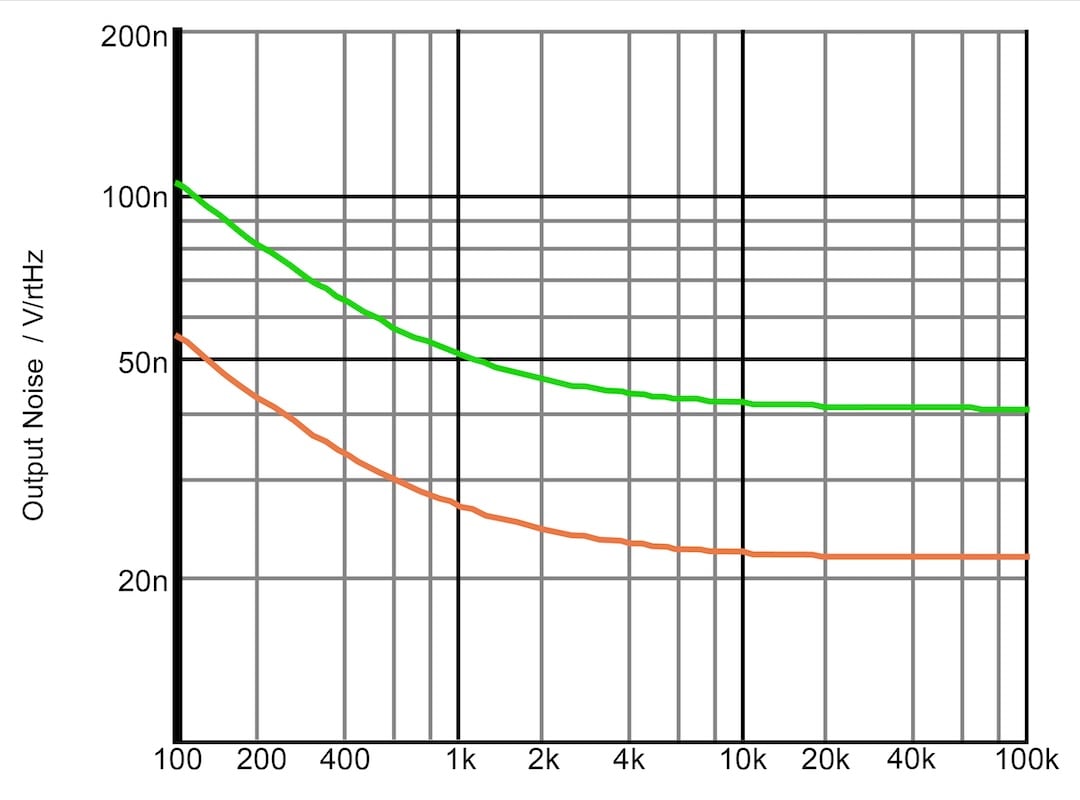

No consideration has been given so far to noise, and it turns out that the noise performance of this design is not that great. The majority of the noise is created in the input stage—in subsequent stages, the signal is larger, and the influence of noise is correspondingly reduced. To lower the noise in Q1 and Q2, the devices need to be larger and their operating current higher.
Figure 10-9 shows the noise performance of this amplifier in the buffer configuration. Note that since the gain is one, output noise and input noise are equal. For the orange curve, the bias current, I1, is 100 μA. Reducing the bias current to 10 μA results in the noise curve shown in green.
Noise versus frequency for a bipolar op amp with two differentcurrents
Figure 10-9. Noise of the bipolar amplifier in the buffer connection. Green: I1 = 10 μA. Orange: I1 = 100 μA. [click to enlarge]
As you can see, lowering the operating current increases noise—an unpleasant fact of life.
