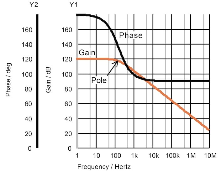

R1 and C1 cause the single delay—in other words, the phase shift. Figure 8-2 shows the simulation results for the circuit of Figure 8-1.
Gain and phase plot for a single-pole circuit
Figure 8-2. In a single-pole circuit, the phase never goes below 90 degrees.
Due to the RC network, the amplitude at the output (gain) starts decreasing at about 100 Hz. At this point, the phase of the signal at the output is considerably less than 180 degrees. As we go higher in frequency, though, the phase never goes below 90 degrees. The signal being fed back to the input can’t reach a phase shift of zero degrees, which is the condition for oscillation.
The point at which the phase has decreased by 45 degrees is called a pole. At frequencies somewhat higher than the pole, the amplitude drops by 6 dB per octave (doubling of frequency) or 20 dB per decade.

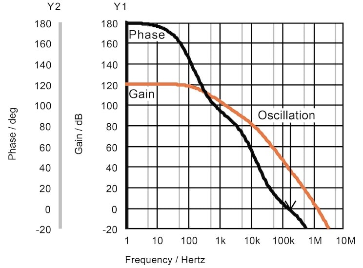

Finally, Figure 8-4 shows the gain and phase plot for a three-pole circuit. With three poles, we’re clearly out of luck. The phase now reaches zero degrees a decade before the gain drops below 0 dB.
Gain and phase plot for a three-pole circuit
Figure 8-4. Three poles in a feedback path cause the phase shift to pass through zero degrees, and oscillation takes place.
An amplifier that has these three poles will oscillate. In fact, we can tell with certainty that it will oscillate at 200 kHz.

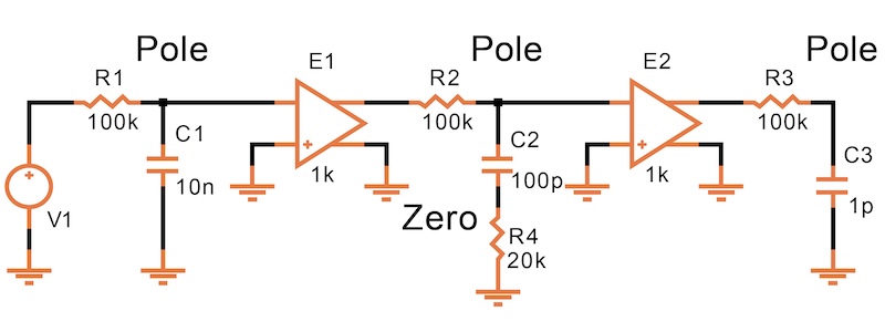

To illustrate the effect of a zero, we use another artificial circuit (Figure 8-5).
Circuit schematic with three poles and a zero
Figure 8-5. Circuit with three poles and a zero.

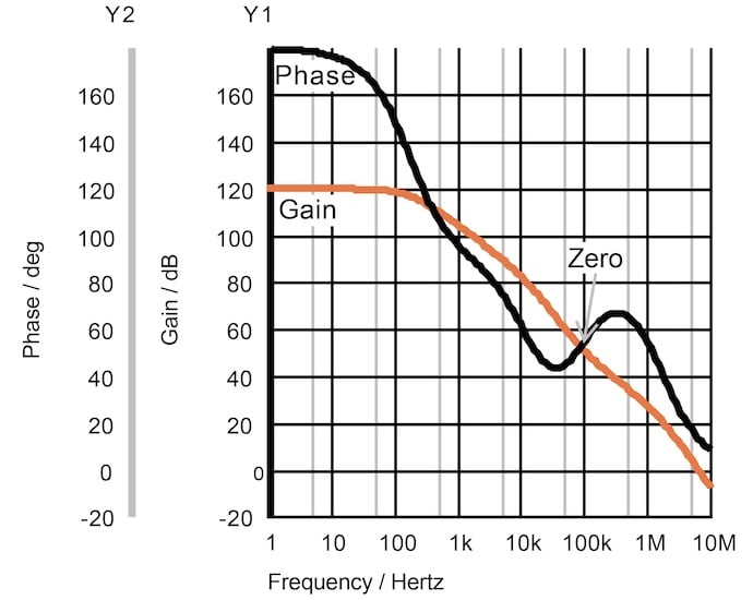

R1-C1, R2-C2, and R3-C3 provide the three poles. Each delays the phase of the signal by the same amount as in Figure 8-4. In Figure 8-6, the combination of R4-C2 provides the zero, which starts turning back the phase at about 30 kHz.
Gain and phase plot for a three-pole circuit with a zero to prevent
oscillation
Figure 8-6. A zero increases the phase (reduces the phase shift).
The value of R4 is selected to result in a frequency where the zero is most effective. At the critical unity-gain frequency (5 MHz), the gain drops below 0 dB, but the phase is still positive (about 15 degrees). The phase at which the gain drops below 0 dB is called the phase margin.
Theoretically, a feedback circuit with this behavior will not oscillate, though the phase margin is rather low. Since gain and time constants are subject to variation in an IC, it should be at least 60 degrees in your designs.
