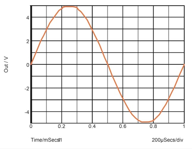

Though the inputs can work at the level of V– (or ground, if you have only a single supply), the output cannot. It is the sad truth for a bipolar transistor that there is a saturation voltage. Unlike a MOS transistor, which is simply a voltage-controlled resistor, the bipolar transistor is the interaction of two junctions with different doping levels and sizes.
There’s a minimum voltage drop of about 150 mV between the emitter and collector in transistors Q13 and Q14 in Figure 10-11, even when they’re fully turned ON. The output can never be at the rails, only approach them. This is illustrated in Figure 10-13 by the slight flattening at the peak and trough of the sinusoidal waveform.
Circuit simulation of a rail-to-rail sinewave show output clipping
Figure 10-13. Output swing is limited by the saturation voltages of Q13 and Q14.

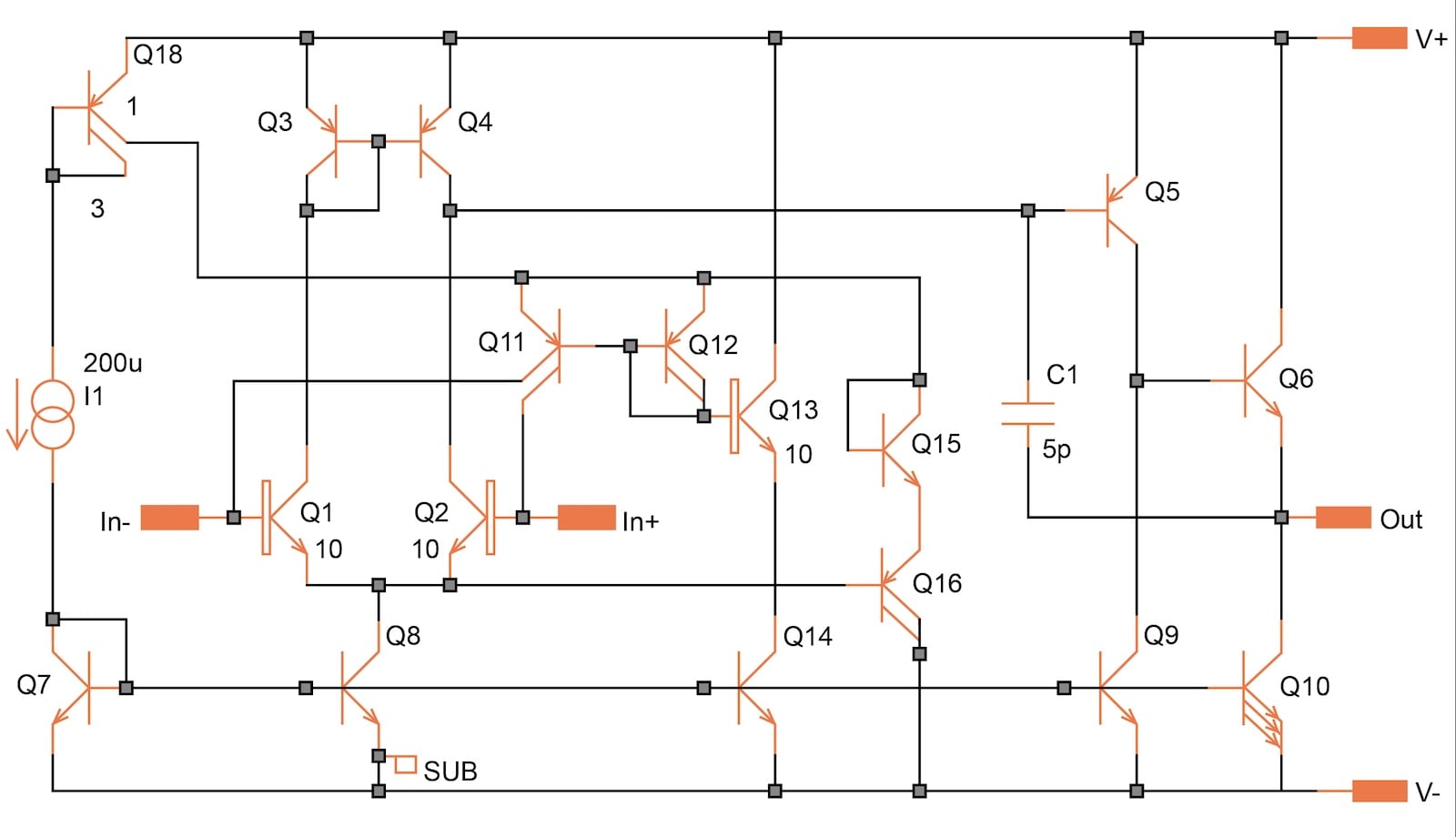

Designing Op Amps for Low Noise
In the last bipolar op amp we’ll examine (Figure 10-15), the goal is not an ultra-low input current. Instead, we’re trying for low noise performance with a reasonably low input current.
Circuit schematic of a bipolar op amp with reduced noise
Figure 10-15. Bipolar op amp optimized for low noise. [click to enlarge]
This circuit is almost identical to the basic NPN-input op amp we saw in Figure 10-1. The input transistors are now again NPN, but with the base-current canceling scheme added.
The key transistor is Q13. Since the hFE of an NPN transistor changes much less with current than that of a PNP device, we can afford to run it at twice the current and then divide the base current by two in the current mirrors Q12/Q11. This brings the input current down to 20 nA.
The operating current is much higher than that of the previous circuit and the input transistors are large. This lowers the white noise to 5 nV/√Hz.
