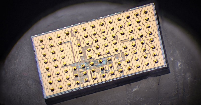

The DC-DC step-down conversion chip
The DC-DC step-down conversion chip is shown on a U.S. penny for scale.
The UCSD team took a different approach, building a hybrid circuit that pairs a piezoelectric resonator with small, commercially available capacitors. Piezoelectric devices store and transfer energy through mechanical vibrations rather than magnetic fields, offering a fundamentally different mechanism for voltage conversion. By combining a resonator with strategically arranged capacitors, the researchers created multiple pathways for power to flow through the circuit. This configuration reduces energy wasted as heat and eases the electrical and mechanical stress on the resonator itself.
The result is a converter that delivers roughly 4x the output current of earlier piezoelectric designs, with only a modest increase in physical size. The 96.2% peak efficiency at a 10:1 step-down ratio is competitive with existing inductor-based converters operating at similar conversion points, but the researchers argue the technology has considerably more headroom for improvement, given how early it is in its development cycle.

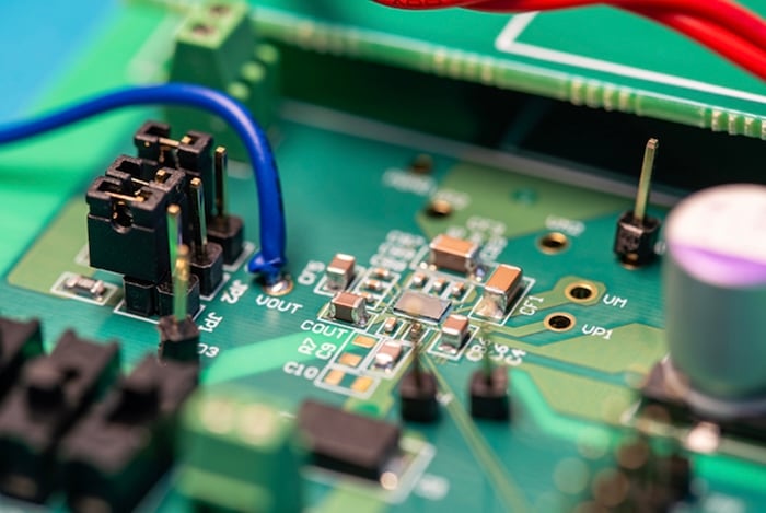

PCB surrounded by capacitors
PCB surrounded by capacitors used to test the DC-DC step-down conversion chip. A piezoelectric resonator is mounted beneath the board and electrically connected to the chip.
