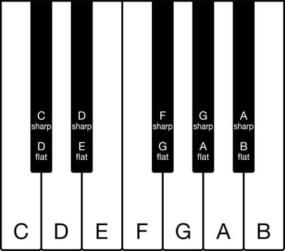

Understanding Musical Notation
Western musical notation uses a 12-note scale. Each note on the scale represents an increase in pitch from the one before it. After the 12th note, the scale repeats, but the frequency of each note is double what it was before. The distance from one note to its nearest counterpart—the note with either one half or two times its frequency—is called an octave.
The scale can be divided into:
  • 7 natural notes.
  • 5 accidental notes.
The natural notes are named after the first seven letters of the Latin alphabet (A, B, C, D, E, F, G). However, it’s more common to begin the sequence with C. The sequence then goes C, D, E, F, G, A, B.
Accidental notes are defined by their relationship to natural notes. Each accidental note is a half-step higher than one natural note and a half-step lower than a second one. We refer to the accidental note either as the sharp(♯) of the former note or the flat (♭) of the latter. For example, the note between C and D could be called either C♯ or D♭. In this project, I’ve chosen to use sharps rather than flats.
The Keyboard Layout
Figure 2 shows the 12-note scale as it appears on a piano keyboard. As you can see, the white keys correspond to natural notes. The black keys on a piano play accidental notes.
One full octave on a piano.
Figure 2. One full octave on a piano. Image used courtesy of Adobe Stock
The Ziggy Stylus features the 25 notes from C3 to C5, which is to say:
