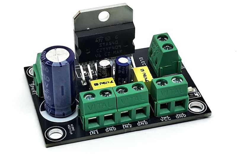

Power, audio, and speaker connections are all made through screw terminals, so the board can be wired into an enclosure without soldering. A power LED (D1) driven from the supply rail confirms that VCC is present. The STA540 itself includes a set of protection and diagnostic features: a clip detector, short-circuit detection at turn-on, a thermal shutdown warning, and AC/DC output short-circuit protection. Figure 1 shows the assembled board.
Figure 1. The assembled Dual 38W Power Amplifier board, built around
the STA540.
Figure 1. The assembled Dual 38W Power Amplifier board, built around the STA540.

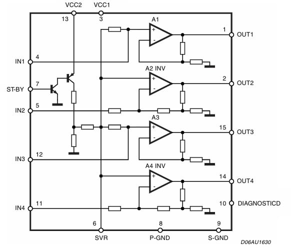

The STA540 is a 4-channel, Class-AB audio amplifier built around four internal operational amplifier stages (A1 through A4), each driving one of the IC's four outputs. On this board the four internal channels are paired to form two bridged, single-ended output pairs (OUT1/OUT2 and OUT3/OUT4), each feeding one of the two speaker terminals, LS1 and LS2. Audio is applied differentially through IN1/IN2 and IN3/IN4. These inputs are coupled through the 470 nF film capacitors C3 and C6 from the CN2 and CN4 input headers.
The standby pin (ST-BY) is pulled through R1 and switched through CN3. This lets an external 5 V signal put the amplifier into a low-power state without disconnecting VCC. Because the STA540 needs no external bootstrap or Boucherot components to drive its outputs, only a few parts remain: C1, C2, C4, C5, and the LED current-limiting resistor R2. Together, these support supply filtering, soft-start, and the power-present indicator.
Figure 2. Internal block diagram of the STA540 showing the four
amplifier channels and the standby switching transistor. Image used courtesy of
STMicroelectronics.
Figure 2. Internal block diagram of the STA540 showing the four amplifier channels and the standby switching transistor. Image used courtesy of STMicroelectronics.

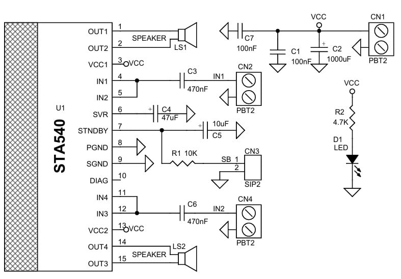

The full schematic for the Dual 38W Power Amplifier is shown in Figure 3.
Figure 3. Schematic of the Dual 38W Power Amplifier board.

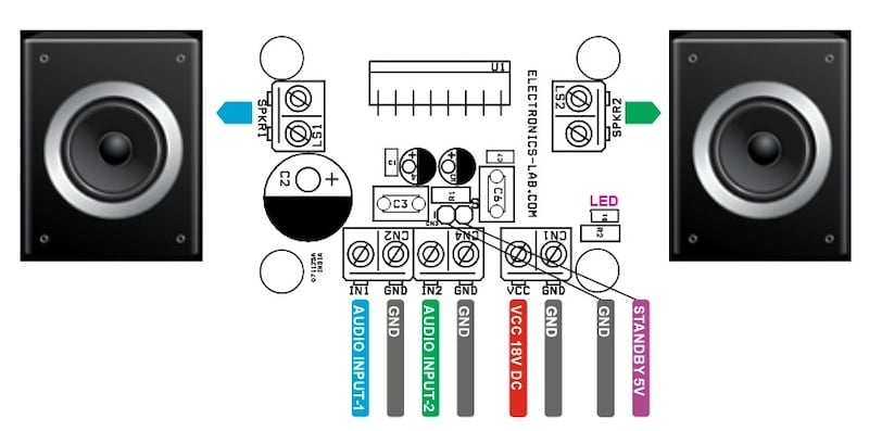

Figure 4 shows how power, audio, and speakers connect to the board.
Figure 4. Connection diagram for the Dual 38W Power Amplifier board.

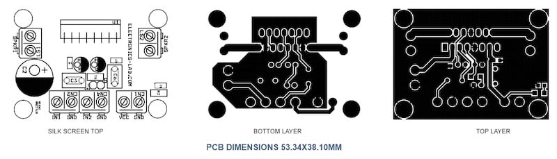

The PCB measures 53.34 mm x 38.10 mm. The silk screen, top layer, and bottom layer are shown in Figure 5.
Figure 5. PCB layout for the Dual 38W Power Amplifier, showing silk
screen, top layer, and bottom layer.
Figure 5. PCB layout for the Dual 38W Power Amplifier, showing silk screen, top layer, and bottom layer.
