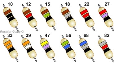

You could have a whole box of E12 series resistors, as shown in Figure 1, but still not be able to get a value close enough to your desired resistance. If you need a 50 kΩ resistor, the closest you will get is 47 kΩ. Sure, that is within 10%, but maybe that isn’t good enough for your application. What are you going to do?
The E12 series resistors with their color codes
Figure 1. The E12 series resistors with their color codes. Image used courtesy of EEPower
