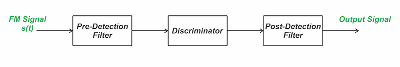

The simplified model of an FM demodulator is shown in Figure 1 below.
Figure 1. Simplified FM demodulation system.

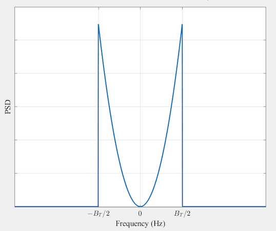

The core component of the system is the discriminator, which essentially extracts the phase of the incoming FM signal and outputs its time derivative. As discussed in the previous article, the noise power spectral density at the discriminator output exhibits a quadratic relationship with frequency, a pattern that emerges from the discriminator acting as a differentiator. Figure 2 shows the typical noise power spectral density at the discriminator output.
Figure 2. Power spectral density of noise at the output of the
discriminator.
Figure 2. Power spectral density of noise at the output of the discriminator.
In the figure above, BT represents the transmission bandwidth of the incoming FM wave. Notably, the primary observation is that the noise power at the receiver output is concentrated at higher frequencies.

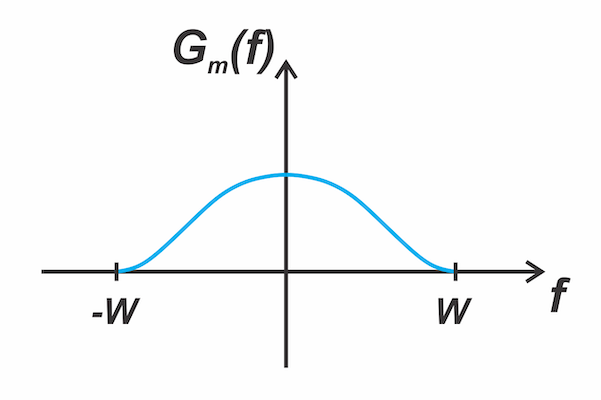

Figure 3 shows the power spectral density of a typical audio or video signal.
Figure 3. Power spectral density of a typical message signal.
In the above figure, W is the maximum frequency of the message signal. We observe that the message’s power spectral density is concentrated at low frequencies and drops off rapidly at higher frequencies. For example, speech exhibits minimal spectral content above 3 kHz.
Comparing Figures 2 and 3, we note that as frequency increases, the signal weakens while noise and interference grow more prominent. This communication system is inefficient because the weaker high-frequency components of the message spectrum coincide with the region where the noise spectrum is most elevated.

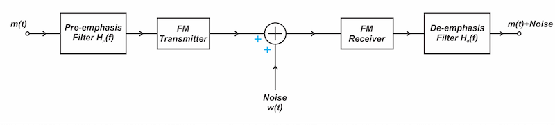

To improve the noise performance, we can use the pre-emphasis/de-emphasis technique. In this case, the transmitter boosts (or pre-emphasizes) high-frequency components of the input signal prior to modulation and before noise is introduced.
Since the high-frequency components of the message were amplified at the transmitter, they must be returned to their original levels after demodulation. This is done by performing the inverse operation—de-emphasis—using a lowpass filter that attenuates the boosted frequencies. This process recovers the original message signal. Figure 4 shows the block diagram of an FM system incorporating pre-emphasis at the transmitter and de-emphasis at the receiver.
Figure 4. Using pre-emphasis and de-emphasis in FM systems.
How does PDE affect channel noise? Since noise is added after modulation, its high-frequency components aren’t boosted by pre-emphasis. However, when noise passes through the de-emphasis filter at the receiver, its high-frequency components are attenuated. Therefore, while the signal remains unchanged, the PDE technique reduces the noise power. We now analyze an FM configuration incorporating PDE to quantify its potential SNR improvement.

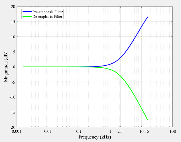

The frequency characteristic of the de-emphasis network is the inverse of that of the pre-emphasis network. Figure 5 shows the frequency responses of pre-emphasis and de-emphasis filters used in commercial FM broadcasting.
Figure 5. Typical 75-μs pre-emphasis and de-emphasis curves used in FM
broadcasting.
Figure 5. Typical 75-μs pre-emphasis and de-emphasis curves used in FM broadcasting.
The de-emphasis filter compensates for the spectral boosting applied during pre-emphasis. Therefore, the PDE process leaves the average message power essentially unchanged.

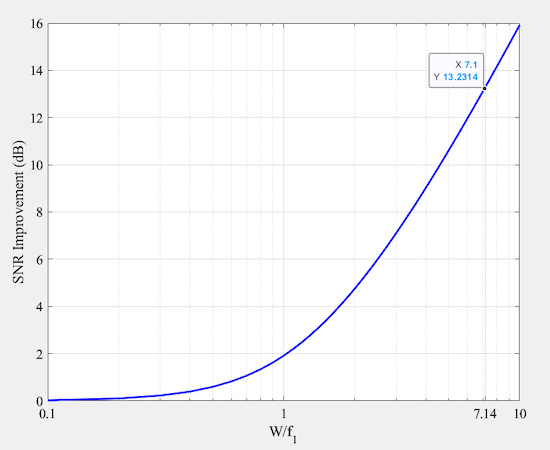

Figure 6 uses the above expression to plot the SNR improvement I against W/f1.
Figure 6. SNR improvement using PDE.
A time constant of 75 µs, which is commonly used in FM broadcasting, yields f1 = 2.1 kHz as calculated below:
$$f_1 = \frac{1}{2 \pi \times 75 \times 10^{-6}} = 2.1 \ kHz$$
Equation 14.

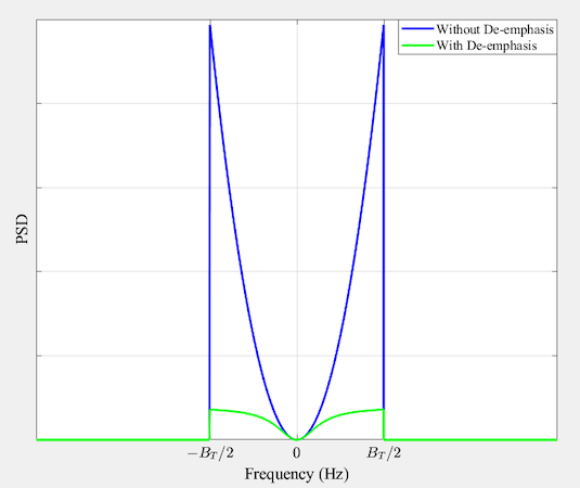

With f1 = 2.1 kHz and W = 15 kHz, the SNR improvement factor works out to I = 21.3, which corresponds to an SNR improvement of 13.3 dB. Without pre-emphasis and de-emphasis, the output SNR of a typical FM receiver ranges from 40 to 50 dB. We therefore see that simple pre-emphasis and de-emphasis filters can significantly improve the receiver's noise performance. Figure 7 provides a plot of the noise spectral density after the de-emphasis filter.

While pre-emphasis enhances high-frequency components to improve noise resilience, it introduces a practical constraint: excessive boosting can lead to overmodulation. For instance, Figure 5 illustrates that pre-emphasis can amplify a 15 kHz signal by as much as 17 dB, potentially driving the instantaneous frequency deviation beyond acceptable bounds. In the next article, we’ll examine this constraint more closely and show that the actual SNR improvement achievable with a 75-µs de-emphasis filter is approximately 6.4 dB—a significant gain, yet considerably lower than the 13.3 dB theoretical value calculated earlier.
