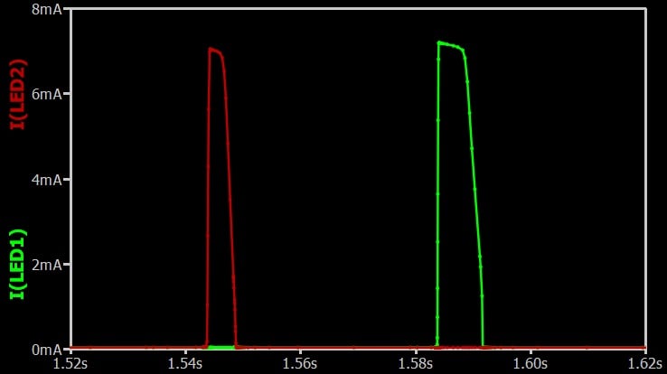

Figure 8 zooms in on a period when the LED is illuminated.
Current through the LED of the workaround circuit (green trace) and the SPICE model circuit (red trace) when the LED is illuminated.
Figure 8. Current through the LED of the workaround circuit (green trace) and the SPICE model circuit (red trace) when the LED is illuminated.

Though the pulse width and oscillation frequency for the two versions of the blinker circuit are different, the differences aren’t extreme. Both versions are useful for simulations, and neither is incorrect—the QTLP690C was selected simply to get the original LTspice simulation started, and a physical circuit would need some trial-and-error adjustments anyway.
