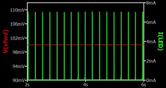

Figures 2 through 4 plot the LED current for three different values of VFWD. We have 100 mV of forward voltage in Figure 2, 400 mV in Figure 3, and 800 mV in Figure 4.
LED blinker circuit with 100 mV of forward voltage added.
Figure 2. LED blinker circuit with 100 mV forward voltage added.
LED blinker circuit with 400 mV of forward voltage added.
Figure 3. LED blinker circuit with 400 mV forward voltage added.
LED blinker circuit with 800 mV of forward voltage added.
Figure 4. LED blinker circuit with 800 mV forward voltage added.
Looking at these plots side by side, it’s clear that the pulse frequency is increasing along with the forward voltage. This is important for practical reasons—because different LEDs have different forward voltage characteristics, it means that the oscillation frequency in a real-world circuit is dependent on the specific LED part chosen. It also leads us to some fundamental observations about how the blinker functions.

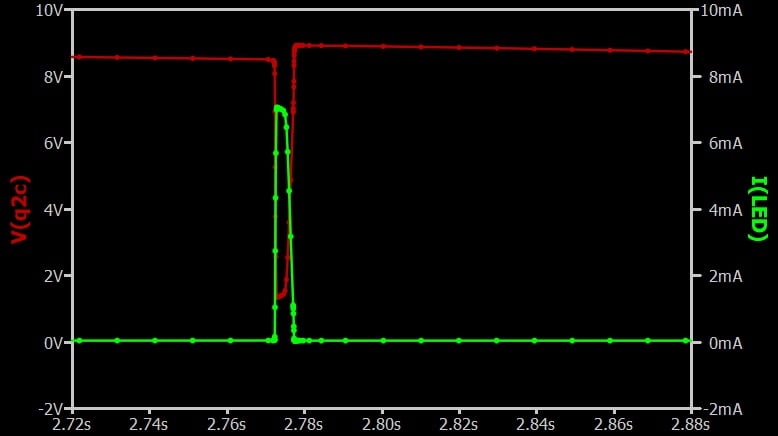

A quick look at the Q2B node in Figure 1 shows us that higher VLED voltage corresponds to higher Q2 base voltage. This suggests that the value of VLED influences Q2’s operation in a way that directly modifies the circuit’s oscillation. Figure 5 shows the relationship between the LED current (green trace) and the voltage at Q2’s collector (red trace).
Voltage behavior of Q2’s collector when current flows through the LED.
Figure 5. Voltage behavior of Q2’s collector when current flows through the LED.
The above figure shows a major drop in collector voltage when the LED is illuminated. This tells us that when the LED is conducting, higher Q2 base voltage causes Q2 to conduct as well. When Q2 is conducting, its collector voltage is lower.

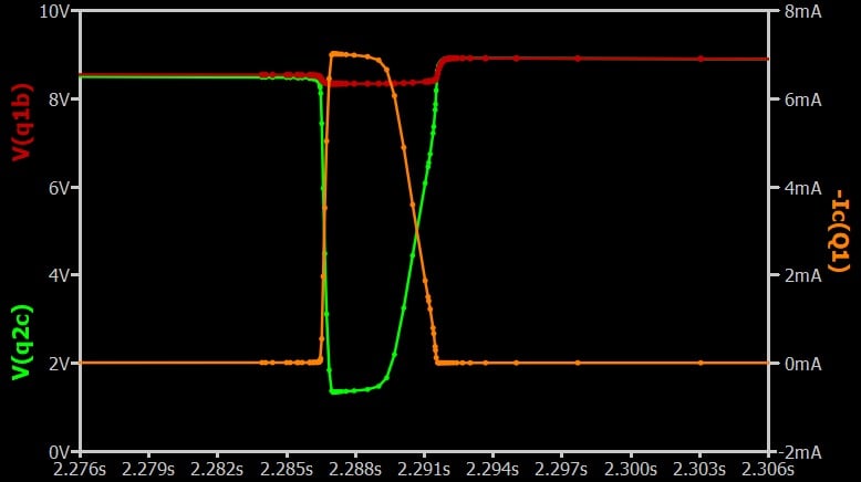

Q1’s base is connected to the Q2 collector node through R2, so its base voltage decreases as well. As we see in Figure 6, the drop in the Q1 base voltage increases the current flowing through Q1.
Q1’s base voltage drops in response to a decrease in Q2’s collector voltage, causing the current through Q1 to increase.
Figure 6. Q1’s base voltage drops in response to a decrease in Q2’s collector voltage, causing the current through Q1 to increase.

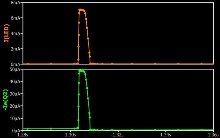

Next, let’s take a look at how the RC network (R6 and C1) can be used to tune the blinker circuit’s frequency and pulse width. We’ll start by examining Figure 7, which plots current through the LED and current delivered to the RC network over the same period of time.
The current flow through the LED and transistor Q2 follow the same pattern.
Figure 7. The current flow through the LED and transistor Q2 follow the same pattern.
We can see that the current delivered to the RC network coincides with the current through the LED, and therefore with Q2’s current as well.

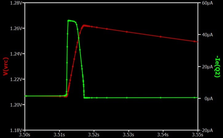

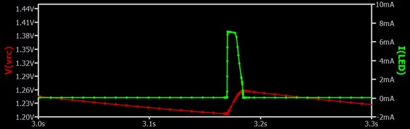

As we observe in Figure 8, the current that flows from Q2’s emitter charges up the capacitor (C1), thus raising the voltage across the RC network (VRC). This current is the key to the circuit’s oscillatory behavior.
The current through Q2 charges up the RC network.
Figure 8. The current through Q2 charges up the RC network.
Q2’s base-to-emitter voltage steadily decreases as VRC increases. When VRC reaches a certain threshold, Q2 stops conducting. This is what causes the behavior of the red trace in Figure 8. Its steep upward slope represents the charging phase, after which the capacitor slowly discharges through R6.

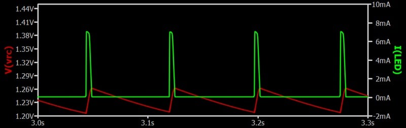

It’s now apparent that the charging/discharging behavior of the RC network is the basis of the circuit’s oscillatory timing. The LED’s ON-time corresponds to the RC network’s charging duration; the delay from the end of one pulse to the beginning of the next pulse is the RC network’s discharge duration. This is illustrated in Figure 9.
A full cycle of the LED blinker showing the charging and discharging of the RC network.
Figure 9. A full cycle of the LED blinker showing the charging and discharging of the RC network.

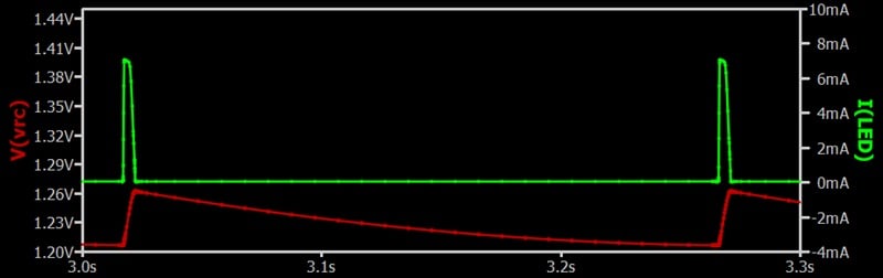

Based on the above, we should be able to increase the frequency by decreasing the value of R6 so that discharge occurs more quickly. Figure 10 tests this by decreasing R6 from 800 kΩ to 400 kΩ.
Pulse frequency with R6 = 400 kΩ.
Figure 10. Pulse frequency with R6 = 400 kΩ.
As expected, lowering the resistance resulted in a higher pulse frequency.
