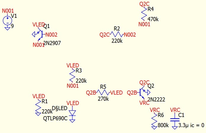

Paste the netlist into the resulting blank schematic by pressing Shift+Ctrl+V. The first component (Figure 4) will appear.
Paste the netlist into the newly created schematic by pressing Ctrl+Alt+V.
Figure 4. Paste the netlist into the newly created schematic by pressing Ctrl+Alt+V.
A single click will place this component on the schematic. You don’t need to hold down Shift+Ctrl+V—instead, just keep clicking to add the other components. This will also place text elements such as simulation commands and .model statements.
When everything has been pasted, you’ll have a jumble of component symbols with net labels. I recommend rotating the components (Ctrl+R) and placing them in the correct position as you paste them in, keeping the LTspice schematic open on one side of your screen as a reference. If you do this, you should end up with something resembling Figure 5.
The end result of the LTspice import process.
Figure 5. The end result of the LTspice import process.
If you don’t do this, you’ll end up with the mess in Figure 6.
The end result of the LTspice import process if you skip the optional steps.
Figure 6. The end result of the LTspice import process if you don’t move the components to the correct positions as you go.

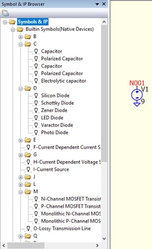

Components are also available from the panel on the left side of the QSPICE window (Figure 7).
The symbol and IP browser can be found on the left side of the screen.
Figure 7. The symbol and IP browser can be found on the left side of the screen.

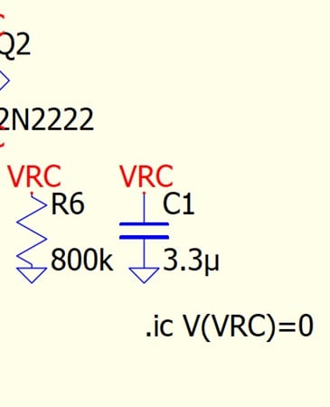

In LTspice, I added an initial condition for the capacitor by using Ctrl+Right-click to open a dialogue. In QSPICE, I’ll just type a .ic statement instead (Figure 9).
To add an initial condition, just type a .ic statement.
Figure 9. To add an initial condition, just type a .ic statement.

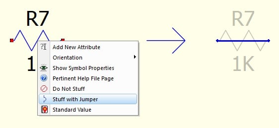

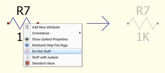

Jumper Stuffing
Since we’re discussing QSPICE’s schematic editor, I’d be remiss not to mention the “Stuff with Jumper” and “Do Not Stuff” options (Figures 13 and 14, respectively). These are located on the same right-click menu as the Selection Guide.
The Stuff with Jumper option.
Figure 13. The QSPICE “Stuff with Jumper” option.
The Do Not Stuff option.
Figure 14. The QSPICE “Do Not Stuff” option.
“Do Not Stuff” and “Stuff with Jumper” are two of my favorite QSPICE schematic features. Testing and refining a simulated circuit sometimes involves eliminating the effect of a component by replacing it with either an open circuit or a short circuit. Via these features, QSPICE allows you to do this quickly and without deleting components that often end up back in the circuit anyway.

    You said “In LTspice, I added an initial condition for the capacitor by using Ctrl+Right-click to open a dialogue. In QSPICE, I’ll just type a .ic statement instead (Figure 9).”
    In QSPICE you can add the initial condition to the capacitor rather than the node VRC, the same as LTspice. Right-click on the capacitor symbol and select Add New Attribute from the context menu. Then type IC=0 into that attribute to set the initial voltage to zero.
