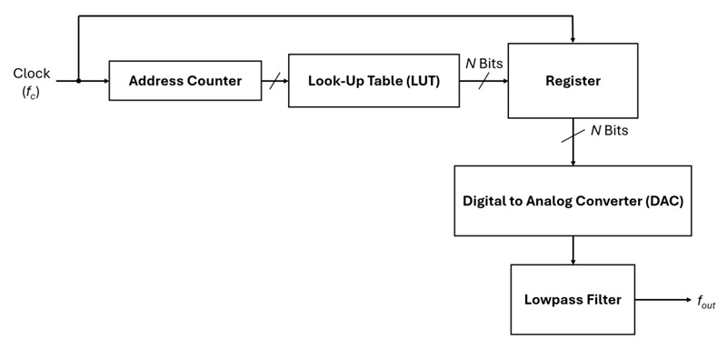

The basic architecture of a DDS circuit is shown in Figure 1. We'll use this diagram as a model when building our sine wave generator.
DDS concept diagram.
Figure 1. DDS concept diagram.
The look-up table (LUT) stores the sine wave's data points. A stable clock with an established frequency (fc) drives an address counter. As the address counter increments, a new digital sample of the sine wave is transferred from the LUT to the register. The DAC converts the digital sample to an analog output value. This output is then passed through a lowpass filter.
Since the DDS process is continuous, this produces a fully represented sine wave. If we wanted to create a square or triangle wave, we could use a different LUT.

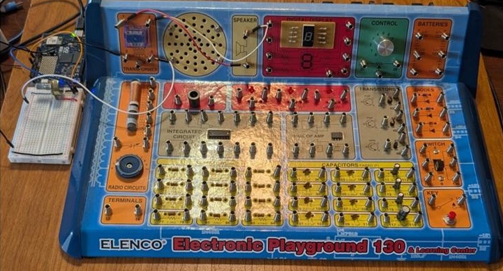

As you can see in Figure 9, I chose to use an Elenco Electronic Playground project kit as my audio unit.
The DDS Sine Wave Generator connected to an Elenco Playground kit for audio output.
Figure 9. The DDS Sine Wave Generator connected to an Elenco Playground kit for audio output.

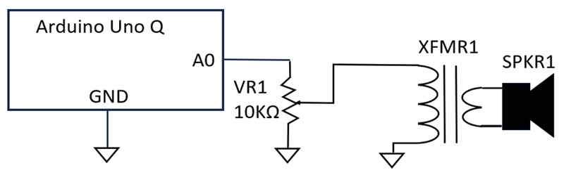

The kit includes a built-in audio transformer and 8 Ω speaker. The audio transformer's primary winding is attached to the 10 KΩ potentiometer's wiper pin and to ground. The secondary winding is wired across the 8 Ω speaker. The circuit diagram is shown in Figure 10.
Circuit schematic for audio output testing.
Figure 10. Circuit schematic for audio output testing.
The audio transformer provides an impedance match between the volume control (VR1) and the speaker. As the volume control is adjusted, we can hear changes in the amplitude. For a demonstration, watch the video clip in Figure 11 with the sound on.
